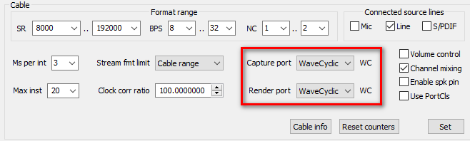

In order for virtual cables to become available in WDM/KS for PowerSDR, you need to change the mode from Auto to WaveCyclic.
Set the virtual cables settings as in the screenshot:
