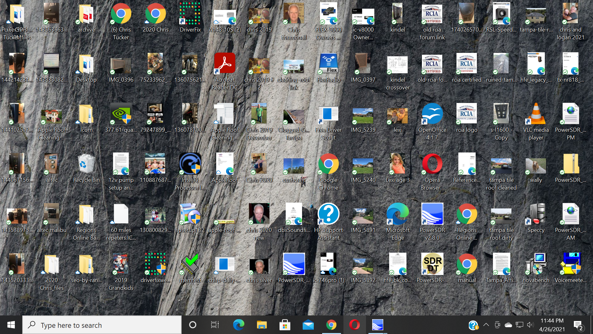

take a screen shot of the full desktop including the PowerSDR console.
Screenshot (1).png (3.58 MiB) Viewed 201098 times
Ok, here goes for the desktop screenshot picture

I meant a screenshot of your desktop with PowerSDR up and running and the tray showing the MIC icon.

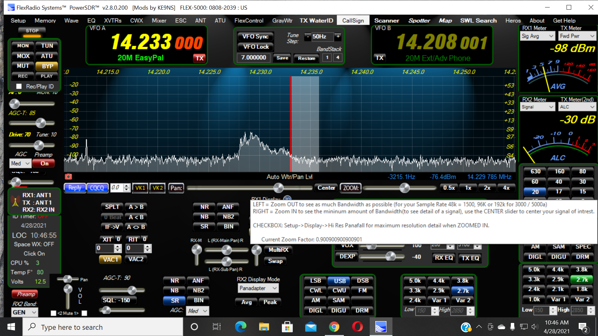

ok, here it is, sorry about that !
Screenshot (2).png (1.02 MiB) Viewed 201087 times

You can see the microphone ICON, in this screenshot.

You have VAC1 turned on. You only need VAC1 ON if you use your PC for a Speaker to listen to the Flex or if you use your PC as a MIC for transmitting.
OR you want to run a Digital Mode of some kind.
So Turn VAC1 OFF and that we free up your PC's default speaker and Mic
