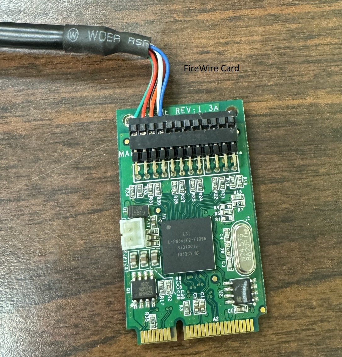

Darrin, I'm trying to replicate this set up but am running into problems. I purchased the StarTech card and the M.2 adaptor that you recommended in your video. The PC recognises the Firewire but not the radio. I peeled the sticker off of the chip and discovered that my card has the TI chip on it. Do you think that could be the problem?
I've tried using the Legacy driver and had the same results. Any suggestions?

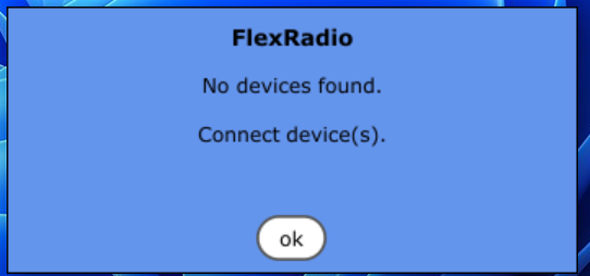

Yes, I can run demo mode although I get the following errors. First
PortAudio Error: -9997 Invalid sample rate
When I click OK for that error I get:
PortAudio Error: -9988 Invalide stream pointer

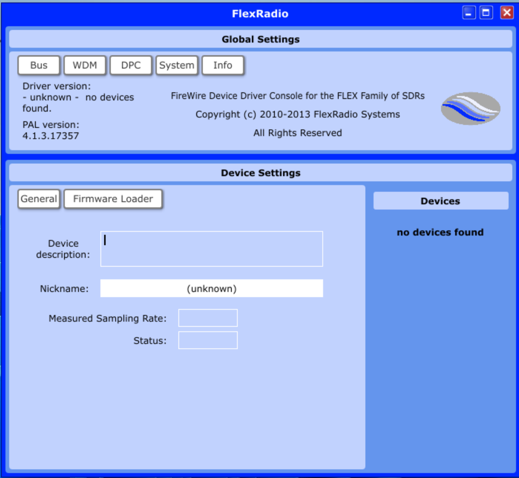

Here are the screens I see when I run FlexRadio.exe:
Screenshot 2024-10-17 155938.png (32.68 KiB) Viewed 71935 times
Clicking OK I get:
Screenshot 2024-10-17 160002.png (124.28 KiB) Viewed 71935 times

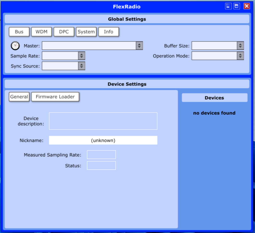

When I click on Info I get:
Screenshot 2024-10-17 160032.png (139.63 KiB) Viewed 71935 times
