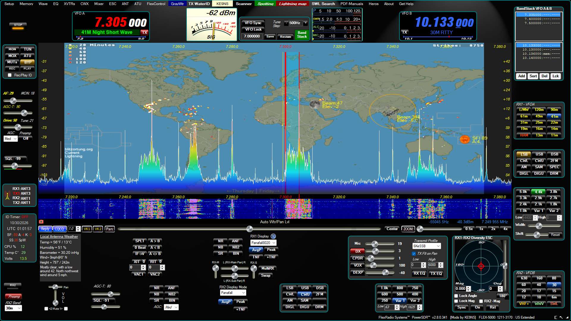

Nov 12 2026 v3.0.0.13: (by KE9NS) Update 3D display. Change from isometric to "Forced Perspective" and changed the code from simple array's to a ring buffer. Gradient colors match the gradient Pan option that was already present. A work in progress
3dpan63dpan8
Nov 10 2026 v3.0.0.12: (by KE9NS) Update 3D display by allowing you to set a display threshold to help clean up a noise display. Also 3D X,Y,Z, threshold now saved to database. A work in progress.
3D3 3d2

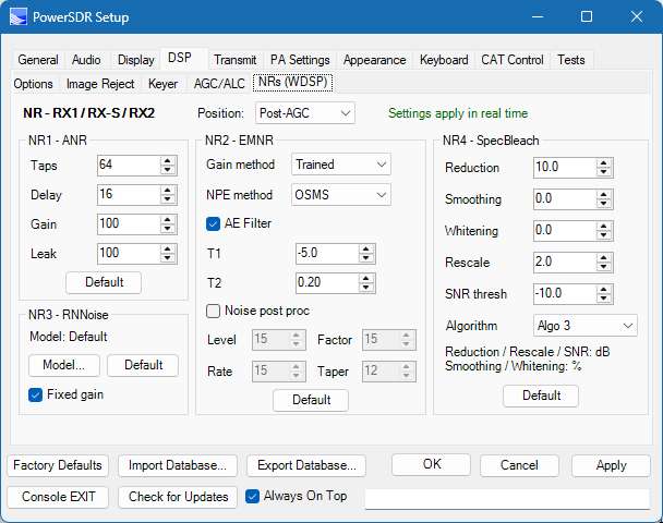

Nov 6 2026 v3.0.0.10 (by PY2ECM, testingPY5VB). Upgrade to latest WDSP 2.11 NNR model 1 x86 with automatic voice/CW models for NR5/NR6 and the existing post-DSP RX1 neural CW audio tap.

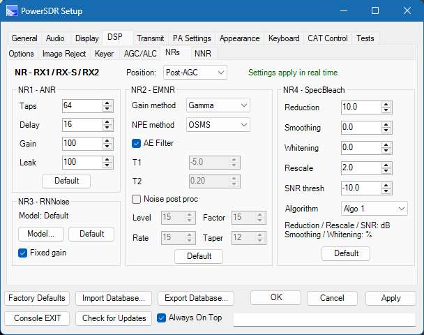

NR1 (ANR — Adaptive Least Mean Squares):
Minimum CPU usage, fast. Can introduce artifacts on voice, including hollowing artifacts.
NR2 (Spectral Noise Reduction / EMNR):
Spectral subtraction or estimation MMSE-LSA or OSMS in freq domain. uses FFT to estimate noise floor in bins.
Effective for SSB and AM voice and cleaner than LMS NR1
NR3 / RN2 (RNNoise-based Neural Denoiser):
open source neural network from rnnoise trained on human speech patterns. recognizes human voice.
NR4 / Specbleach (Spectral Bleach / Statistical Denoiser):
spectral subtraction libspecbleach apply fine-grained smoothing and noise rescaling. Favored for SSB and CW on HF. Strips Hash and avoids artifacts.

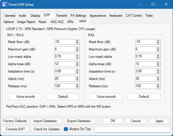

Warren Pratts NNR (Neural Noise Reduction) NR5, NR6 is machine learning using deep neural network trained on audio datasets to dynamically distinguish human speech patterns from background noise, static, and interfearance. NNR generate a continuous spectral mask. It supresses non-voice frequencies while preserving natural speech formats. NNR excels at removing impulse noise, power-line buzz, lightning crashes, and atmospheric hash. NNR requires higher CPU usage.
NR5 NNR Standard Model (WDSP Deep Neural Network):
WDSP native neural network. Deep learning models to differentiate signals from noise. Offers massive improvements in weak-signal intelligibility with min distortion.
NR6 NNR Premium Model (and CW-Specific Variants):
higher capacity deep neural network specialized CW premium models with deeper layers, more complex weight matrices tailored for rigorous voice recovery or CW tone extraction.

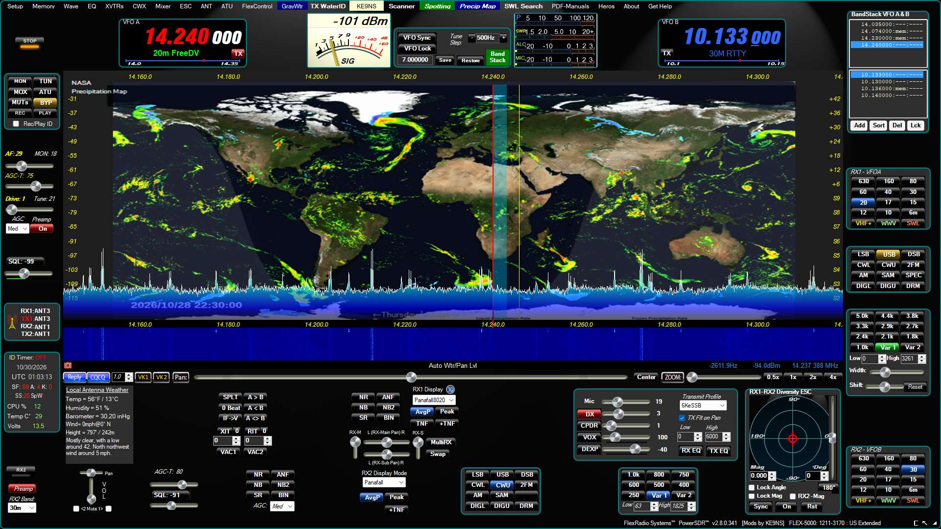

Oct 27 2026 v3.0.0.6: (by KE9NS) Cleaned up Spotter screen layout and added NASA world precipitation map. (Same as v2.8.0.0.340)

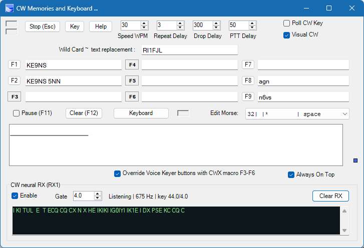

Oct 19 2026 v3.0.0.5: (by PY2ECM, testingPY5VB) Upgraded to WDSP 2.10. Add NR5-6 and CW Decoder (under the CWX panel). NOTE: There is a 1 minute initialization after Starting PowerSDR the very first time (PowerSDR will appear frozen for 1 minute).
CWdecod NR5NB12nr1-4

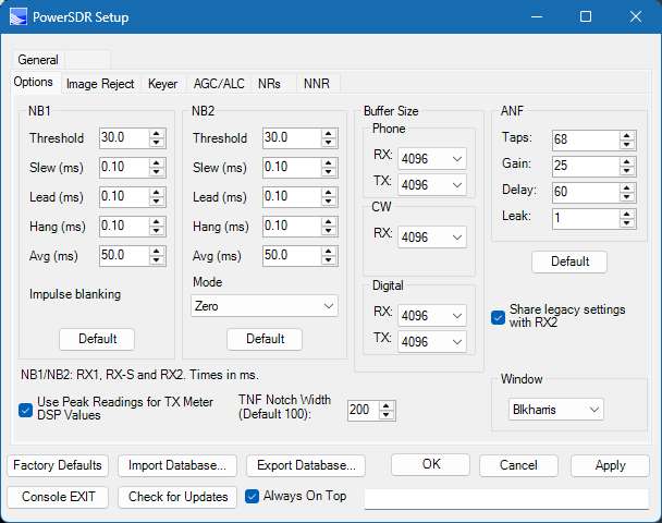

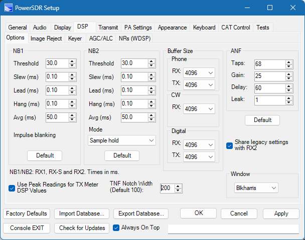

NR1/NR2/NR3/NR4, NB1/NB2 without SNB; shared NR/NB parameter pages;
