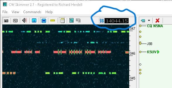

Before CWSkimmer frequency change:
Before
Before
After CWSkimmer frequency change:
After
After

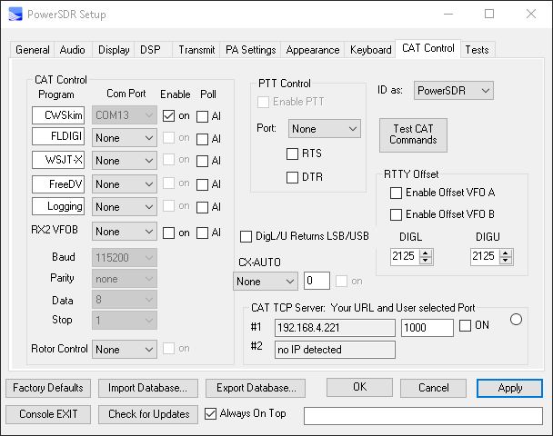

Flex CAT config:
Flex Config
Flex Config

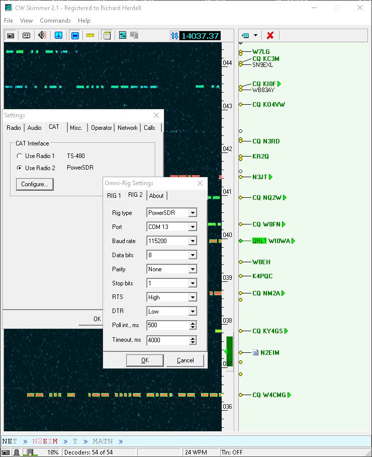

CWSkimmer CAT config:
CW S Config
CW S Config

Resolved! I had created a connector. It needed to be a pair with unique com ports on each end. Clearly stated on Darrin's website about setting up VSPs. Feel pretty dense! :oops:
