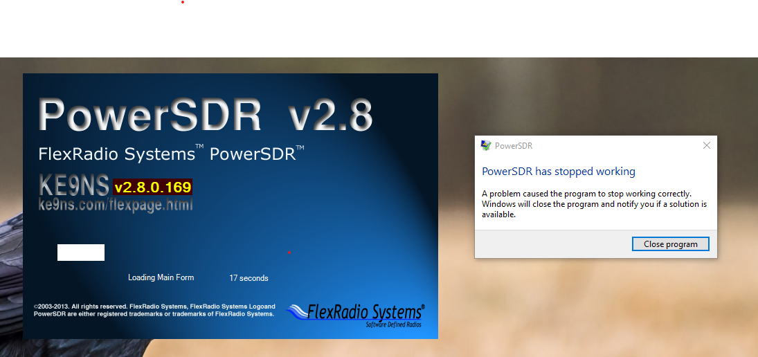

Darin It,s back to the same thing again. But Flex software works and the demo mode works. I got it going from the .167( I think) by removed all folders pertaining to 2.8 and doing a fresh install. I didn't do all the settings changes at once . I would do a few and export the data base.Got it where I wanted it almost.Not sure hat I did on the last shutdown but I stopped using the stop button and just used the X.also I had a few windows open, setup,
EQ and ant. In the EQ I had the 9 band and the 28 band together button checked. I was messing with the audio before I shut down. Before I just had the 3 band going.
Hhow do I import a saved working .xml file when the program won't open? Will a import in demo mode work? I'm sure It's something in the setup configurations that not working together. Thanks Walt N4RWW
Annotation 2020-06-04 114214.png (283.29 KiB) Viewed 27749 times
Posts: 575
Re: PSDR lockups during startup
You would need to go into the database folder: %userprofile%\AppData\Roaming\FlexRadio Systems\PowerSDR v2.8.0\
Then remove any file with your radios serial number in the file name (you may have 5 or more files).
Launch PowerSDR and then do a setup->Import database
Darrin ke9ns
