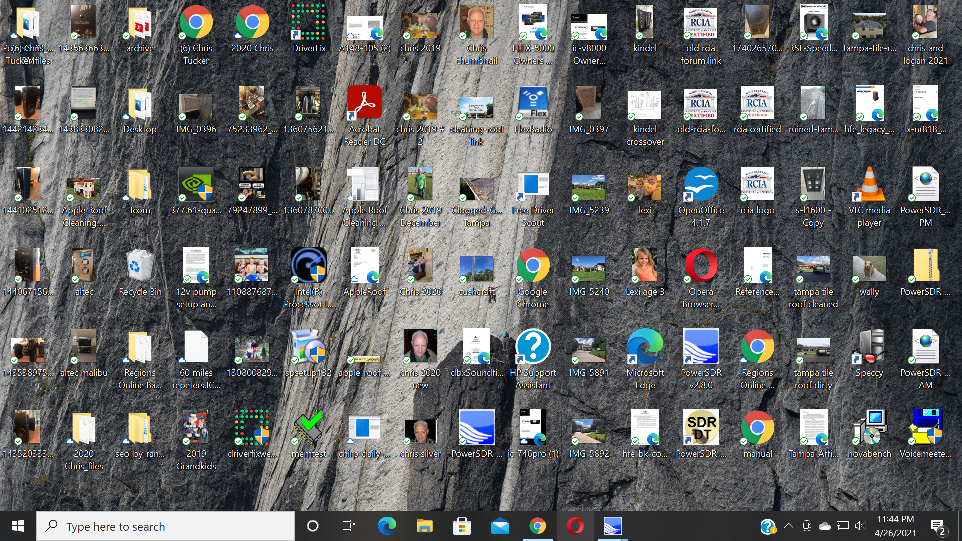

take a screen shot of the full desktop including the PowerSDR console.
Screenshot (1).png (3.58 MiB) Viewed 69031 times
Ok, here goes for the desktop screenshot picture

I meant a screenshot of your desktop with PowerSDR up and running and the tray showing the MIC icon.

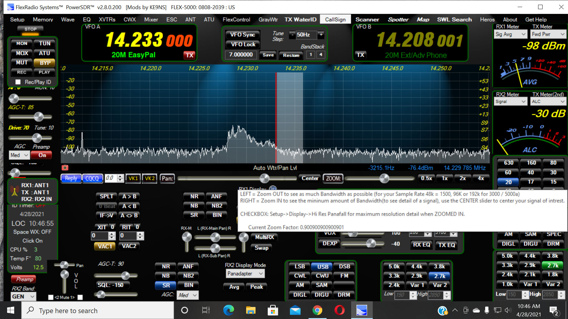

ke9ns wrote:
Tue Apr 27, 2021 10:34 pm
I run a push-button hand switch on the desk and a foot switch on the floor tied in parallel to the RCA PTT on the back of the Flex. Works well.
I still put Ferrite on all the cables at the back of the Flex and PC and tuner and Amp just to be sure.
ok, here it is, sorry about that !
Screenshot (2).png (1.02 MiB) Viewed 69020 times

You can see the microphone ICON, in this screenshot.

Posts: 575
Re: Power SDR Crashing On Flex 5000
You have VAC1 turned on. You only need VAC1 ON if you use your PC for a Speaker to listen to the Flex or if you use your PC as a MIC for transmitting.
OR you want to run a Digital Mode of some kind.
So Turn VAC1 OFF and that we free up your PC's default speaker and Mic
