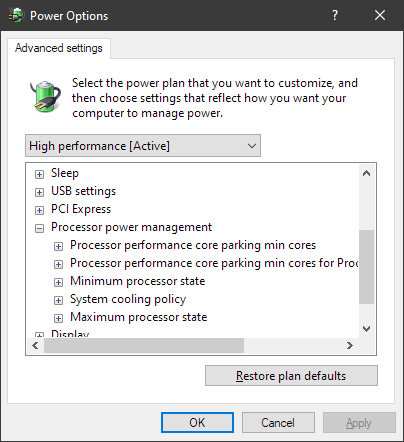

My Solution:
1. With the LatencyMon program to check latency for realtime use.
2. If the drops, increase the "Processor performance core parking" value.
instructions on how to enable the item:
regedit
Find 'dec35c318583' only in 'Power Setings'
change 'Attributes' to 0
now accessible item:
Control Panel / Power Options / Procesor performance core parking (The original value was 4, I increased to 5)
I tried on several PCs and somewhere it was enough to increase the value to 5 and somewhere 40 somewhere 80.
Now latencymon no longer reports audio drops, and Powersdr does not freeze win11 even if the PCI IRQ remains shared with graphics card.

I always keep my PC on "High performance" mode (and PowerSDR Setup->General->Options->Process Priority->High) but I forgot that Windows does not default to "High performance" mode. Good Catch.
I would say anyone running PowerSDR should set the Windows Control Panel->Power Options->High performance.
FYI
Found an explanation of what Core Parking is:
Core Parking is a sleep state (C6) supported by most newer x86 processors, and newer editions of Windows. Core Parking dynamically disables CPU cores in an effort to conserve power when idle. Disabled cores are re-enabled as the CPU load increases once again. This technology is very similar to frequency scaling, in that it seeks to throttle the CPU when idle.
The problem is that Window's default power profiles are configured far too aggressively when it comes to core parking, especially on workstations. Their interest was in conserving energy, even if this meant marginally decreasing performance. A number of complex parameters control when a core should be parked, and Microsoft tuned heavily towards power savings.
The core parking settings in Windows are implemented as parameters of power plans (aka power profiles). That means you can, for example, disable core parking for the High Performance power plan, but leave it enabled for other plans. And that is exactly the desired tweak for most users: disable parking only for high performance power plans.
The full string people should search for is:
[HKEY_LOCAL_MACHINE\SYSTEM\CurrentControlSet\Control\Power\PowerSettings\54533251-82be-4824-96c1-47b60b740d00\0cc5b647-c1df-4637-891a-dec35c318583] (Then set the attribute = 2)
Navigate to: Control Panel\All Control Panel Items\Power Options\Edit Plan Settings
Then click on "Change Advanced power settings"
Now under "Processor Power management" you will see an additional option of "Processor performance cor parking min cores"
Make sure to set your Power Plan to "High performance"

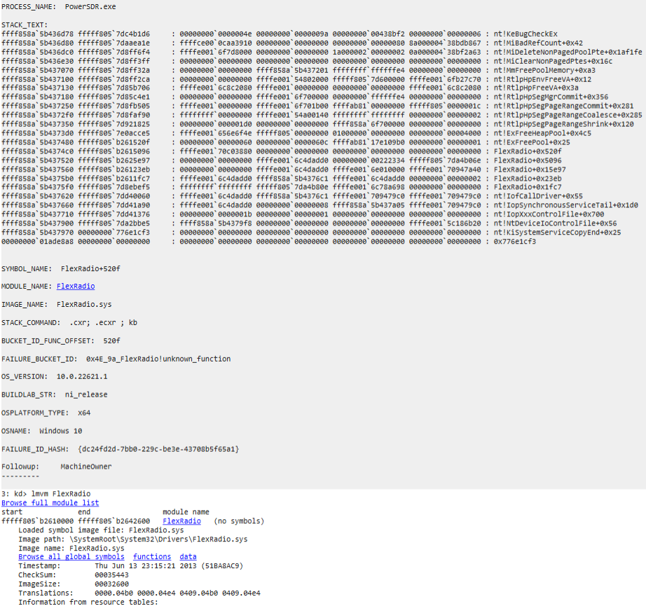

Analyzing the dump file after a PFN fault reveals the same offender for me each time.
Of course, this is all tripping up in the Flexradio.sys driver of which we have no source.
But for your reading pleasure please see the attached text excerpt from WinDbg. (process details are closer to the bottom)

SYMBOL_NAME:  FlexRadio+520f
MODULE_NAME: FlexRadio
IMAGE_NAME:  FlexRadio.sys

I've tried to step into the process with the debugger, but because the issue is seemingly inconsistent it's hard to diagnose or pin down the bit where it faults.
Of course, I have tried disabling all other sound devices as well as resolved all IRQ sharing conflicts.
It just faults on some unknown function sent to flexradio.sys and the dump shows the same thing and memory location every time.
what isn't showing up are the symbols for debugging the stack.
one thing that does stand out that IDK is a red herring or not is that the instruction it kicks out on is :
Code: Select all
nt!KeBugCheckEx:
fffff805`7da16b70 48894c2408      mov     qword ptr [rsp+8],rcx ss:0018:ffff858a`5b436d80=000000000000004e
Usually, from what I have learned...the offset notation would have an 'h' after the stack frame memory location i.e. [rsp+8h] but this one instruction does not. if you step through the next instruction does have the hexadecimal notation. That being said, this is compiled code so I think the system knows what and where. I think the issue is like you said, there is some enhancement in the new OS that is glitching this out.
I'll do some more log digging...
IDK. this may be a fun problem to solve, (BTW I'm running Windows 11 Pro 23H2, but something told the debugger that it's 10)

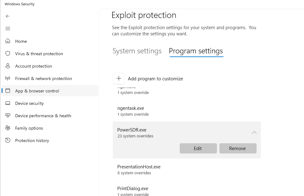

With that Defender idea in my head, the one thing I'm giving a try is to run a custom exclusion list in the exploit protection features.
Long shot, but I wonder if the interrogation could be causing some sort of issue?
Posts: 574
Re: Firewire Win11 PFN LIST
Someone also said to make sure control panel Power Options was set to High performance and to set "Core Parking. Meaning that we dont want the OS to shut down CPU's to save on power consumption while running PowerSDR. I believe I put that info on my webpage.
I know that some BIOS settings allow you to enable/disable other CPU power settings (more Core Parking stuff). I normally disable all the power reduction features in the BIOS. My Ryzen runs cool so I dont worry, and I dont overclock it.

Okay.. even with the override exclusions we still enjoyed the pleasure of a PFN after a while.

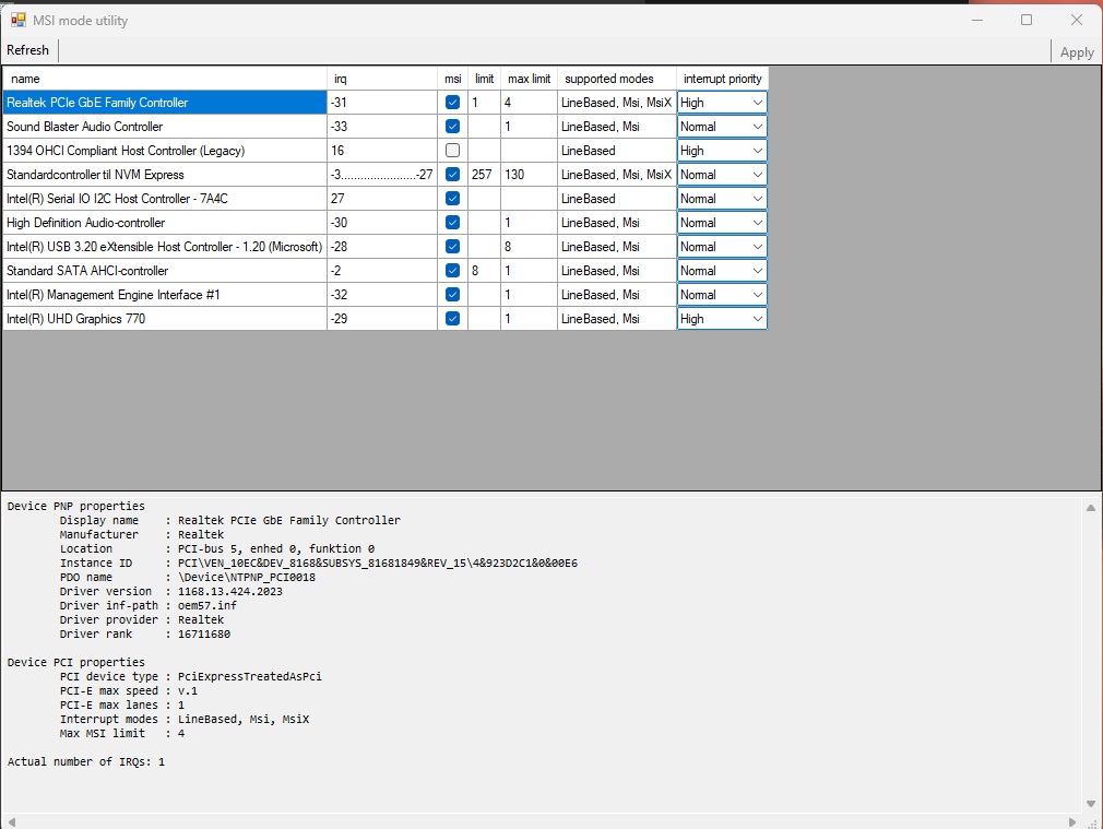

Joined: Mon Sep 07, 2020 7:32 am
Post by oz2pm »
Thanks for finding that information om1ei
It helped me a lot
I tried something a fresh setup in MSI util v3
and it got even better
I often had a dcp over 4000 and when I pressed a button in powersdr I got a PC crash
so far it's running fine but still testing
MSI MODE.jpg (152.9 KiB) Viewed 79947 times
