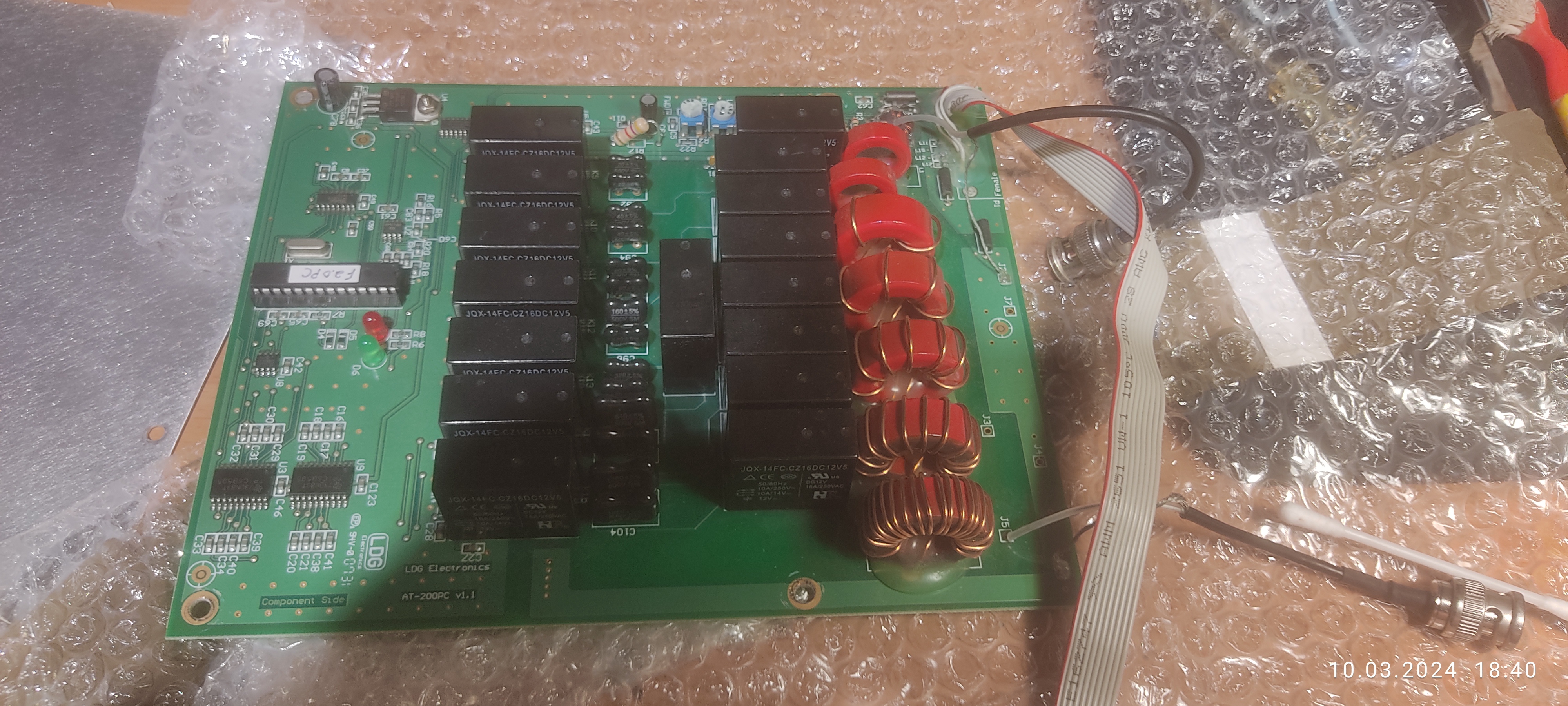

I've got myself a Flex 5000a which is working great. I got an internal ATU. I've made an RF shield plate and installed the ATU
It isn't recognised by the Flex ?

The program shows all my Radio config details correctly but in the ATU section, Revision was 255, C and Week Year Sequence was 255 255 65535
Now my ATU is the old version made by LDG with the BNC pigtails. Ive edited the ATU section and now it reads 52 B, 07 11 2710 and I write to EEPROM and reboot.
Now in PowerSDR Setup/General/Hardware config/ ATU: 0711-2710 (52B). Bad news, I tried the ATU and It still didn't work :-( I read more about the LDG ATU and of course it is the OLDER version ? (OLDER) I change the EEPROM config to 52 A (not 52 B) just to try it and.............SUCESS
Now in PowerSDR Setup/General/Hardware config/ ATU: 0711-2710 (52A) ATU works fully and full power in Bypass AND after FULL Tune or Memeory Tune. Fully working 100 watts with or without ATU on/off. I'm so happy and what a relief. I can't believe how good the ATU is. It tunes everwhere.

this was my Tuner in my old Flex 5000 which has always worked without any problems from day one
lou
LDG Tuner flex 5000.jpg (2.32 MiB) Viewed 12717 times
