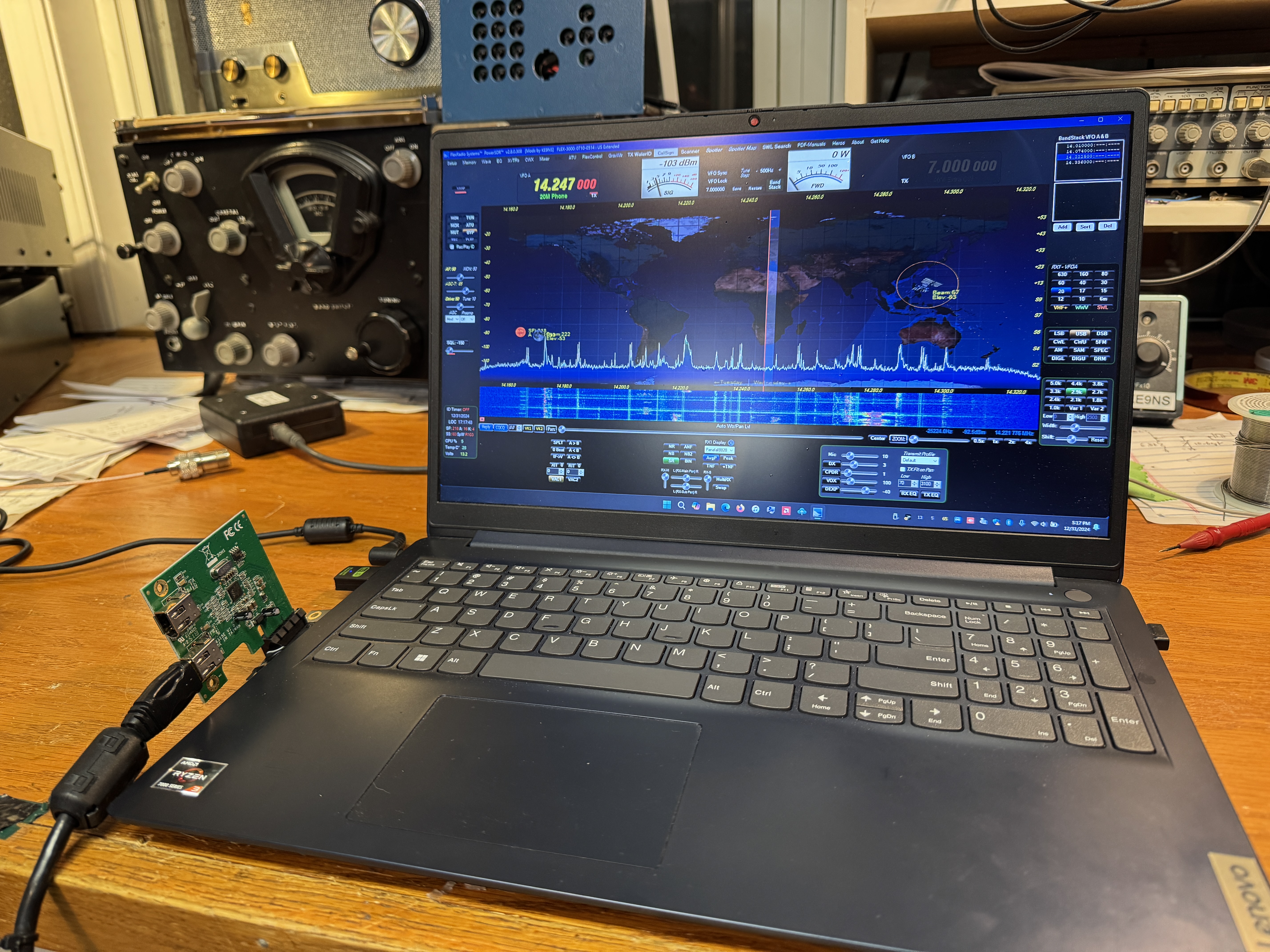

Running PowerSDR on my Lenovo Ryzen laptop, i tried a few different PCIe cards (see image below)
I found 1 card that was causing PFN crashes, and 1 that has no issues.
Under win11 you can no longer use the legacy FireWire drivers because Win11 requires a signed driver (which the version i was able to find is not signed).
