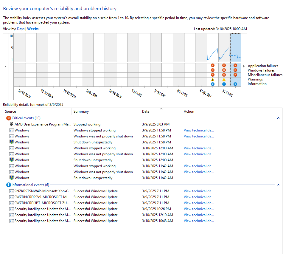

I got the report, do you want me to email it to you? Screenshot it here maybe.
Re: Predictable BSOD on save
You can just screen shot it here.
Screenshot 2025-03-10 114445.png (89.26 KiB) Viewed 10735 times
So minor update/correction. 48000khz works with PSDR 2.7.2 but not 2.8.
The computer is an AMD Ryzen 5 8600G. 64GB RAM, 64bit Windows 11 pro
Installed TI Firewire card.
It should be able to easily handle 192K, my 10 year old heap did it without an issue. So I am wondering if there isn't some configuration or driver that isn't set right.
