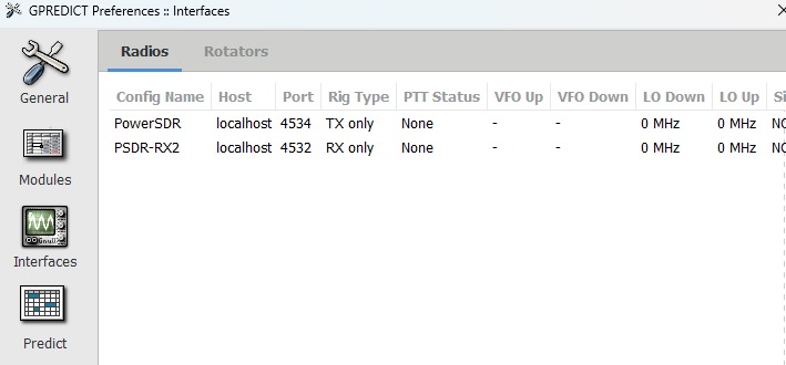

Ahh gave it another go. This time I didn't rely on GPredict to drive VFOA and VFOB with just one Radio Interface defined.
This time around I created a radio called PSDR-RX2 and made it an RX only radio. I also remembered to change the darn port of Hamlib for the 2nd instance.
In PSDR I set the CAT settings like this for the test:
Then the start-up file looks like this:
Code: Select all
start C:\Users\Owner\Desktop\HamRadio\Satellite\gpredict-win32-2.3.37\gpredict.exe
cd "C:\Program Files\hamlib-w64-4.5.5\bin"
start rigctld.exe -vv -m 2048  -r \\.\com10 -s 57600 -t 4534
start rigctld.exe -vv -m 2048  -r \\.\com9 -s 57600 -t 4532
The VFOA and VFOB are now updating. Is this similar to the approach you tried? I just couldn't get VFOB to update out pf the box with one radio def.
I'm used to using FlexSatPC but there are a lot of things I prefer In GPredict over SatPC32
Also tried with TX only on VFOA this seems to move the dials also.. and the Lock together VFO feature works as well

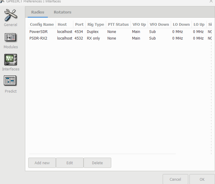

Re: .278 GPredict tests
I found the issue was Gpredict wants to see the radio in SPLIT mode to operate correctly (which is nonsense).
So the moment you turn on RX2, the SPLIT goes away and causes the full duplex to fail.
In .278 I make sure that CAT commands see that we are in SPLIT when TX is on VFOB and RX2 is ON
I also allow you to LOCK TX to VFOB (PowerSDR normally put TX back to VFOA every time you change bands, which again does not make sense)
1) Set TX to VFOB
2) Right Click on the VFOB TX button (to lock it)
3) Set the rigctld.exe->Properties->Target to: rigctld.exe -vv -m 2048 -r COM12 -s 57600 (with COM12 being one side of a virtual com port pair, the other side needs to be in PowerSDR->Setup->CAT
4) Run rigctld (it should open up a DOS window for any faults that might occur), you can minimize it
5) open Gpredict->Edit->Preferences->interfaces->Add new-> Host=Localhost, Port=4532, Radio Type=Duplex TRX, PTT Status=NONE, VFO UP/Down=B/A
6) Also setup a satellite group of working satellites:
7) Click on Down arrow (upper right side of Gpredict)->Radio Control.
8) On the Radio Control screen, select the Satellite (Target), Select the Mode (just under the satellite name),
9) Hit the "Engage" button, and the bands on PowerSDR should change (MAKE ABSOLUTELY SURE YOU LOCK TX ON VFOB FIRST WITH RX2 ON)
10) Hit the "Track" button to engage Doppler offset
