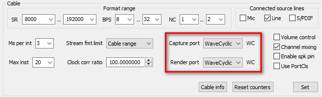

Greetings. I also searched for the cause of the blue screen for the same time, changed the driver and reset it to the factory settings, but nothing helped, the bsod periodically appeared without any regularity. For some time, I still found what affects this behavior, having installed another virtual cable from VB-Audio, I noticed that the bsod was gone, and I began to study this direction further. After studying various documentation of both portaudio and virtual cables from Muzychenko, I found a solution to this problem. In the latest versions of the virtual cable from Muzychenko, by default, the Port class driver port/miniport types setting turns on the WaveRT mode, which works very badly in this case with the audio port. The solution to the bsod problem was the choice of the WaveCyclic mode. So if you use virtual cables from Muzychenko, try changing the settings of your cables (I will attach a screenshot of the settings just in case).
