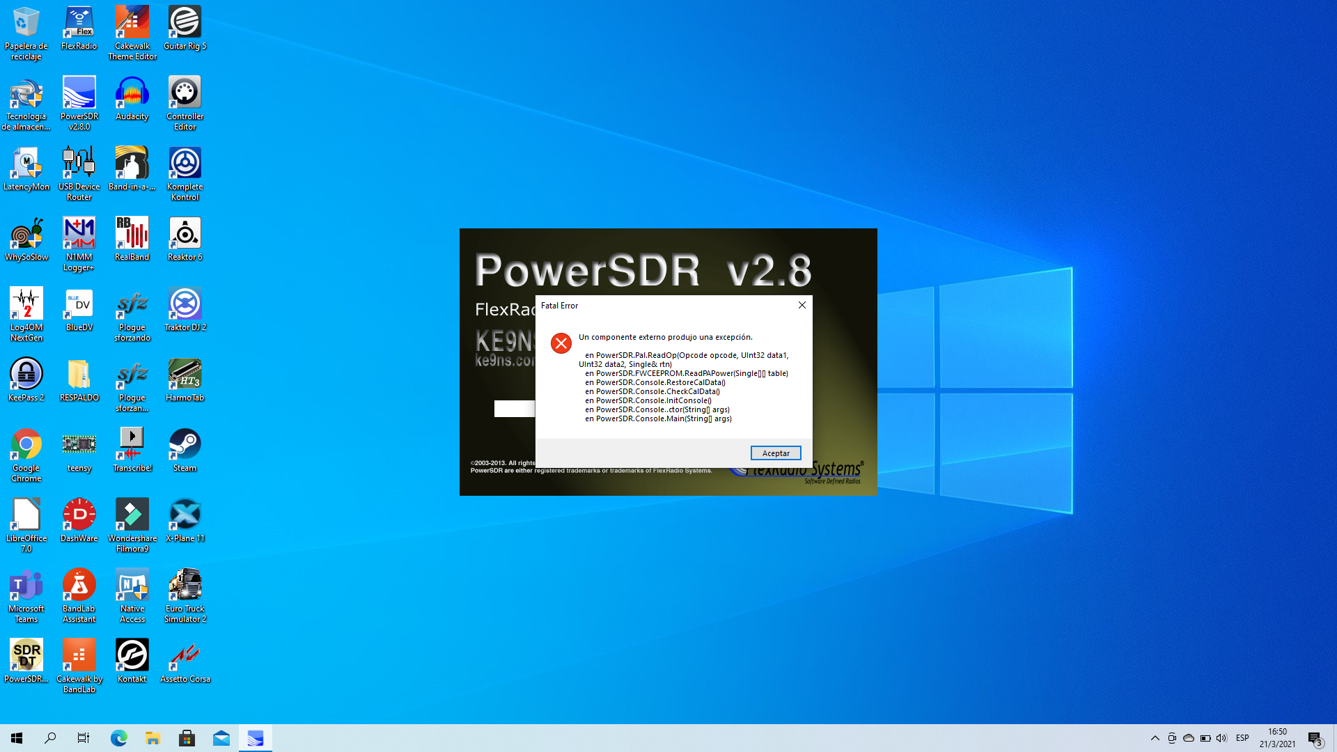

What can I do to fix this error?

was it working before, or is this the first time your trying to install and run v2.8?

First time in this notebook
Re: Can´t open PowerSDR
What Model radio do you have?
disconnect your radio and run PowerSDR in DEMO mode. Does it run in DEMO mode?

My Radio is a Flex-3000 and I can run in Demo mode
If you can run in DEMO mode, then its something to do with the 1394 FireWire.
I have some info if you click on the FireWire link, left side on my webpage (like running the FlexRadio.exe program)
