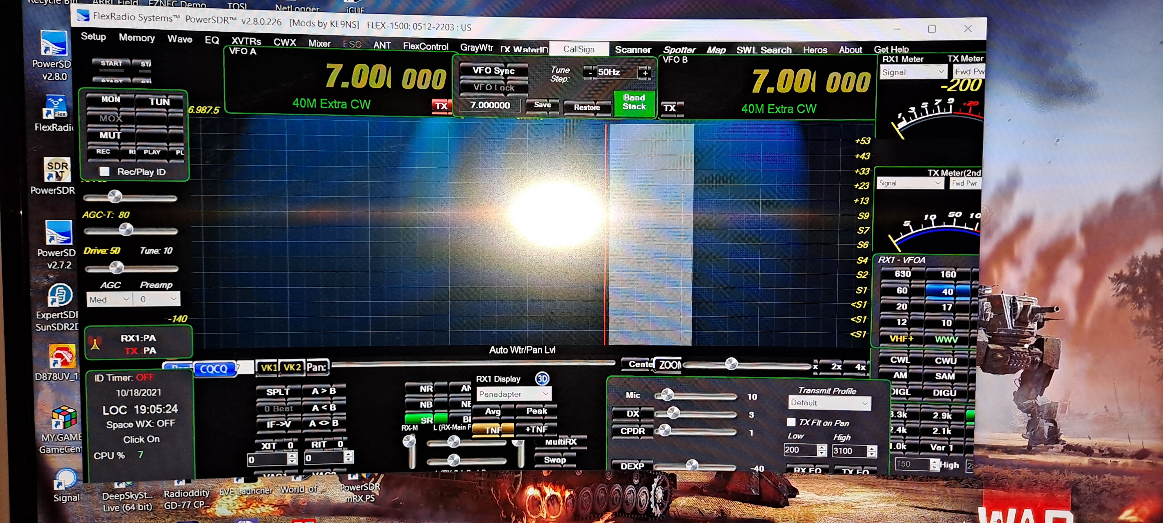

i have a flex 1500 and i have havent ran it in a couple of years anyway i loaded the software up and turned on the radio and the splash screen as a double image and when the app finishes loading i get things over lapping and the edges of other things not showing and when i change bands it will lockup and when i shut it down it sends a report to windows i have uninstalled and reinstalled several time to no advail!
Anyone one know whats going on? 73 Dale N4XLD

The only time I have seen a double image is when you have Display scaling turn on to something other than the normal 100%
For example: You have a 4k (UHD) monitor and have scaling turn on because everything is so small (and you trying to make it larger, easier to see). PowerSDR will not play nice.
So make sure PowerSDR (right click on desktop icon-> Properties->Compatibility) does not have anything set except admin mode so PowerSDR can update your PC time clock when using the Spotter screen). And make sure Windows does not have any Display scaling turn on (right click on open desktop area->Display Settings)
If you run a resolution less than 1920 x 1080 (HD), it may squish everything to make it try and fit, but it normally does not double image it.
