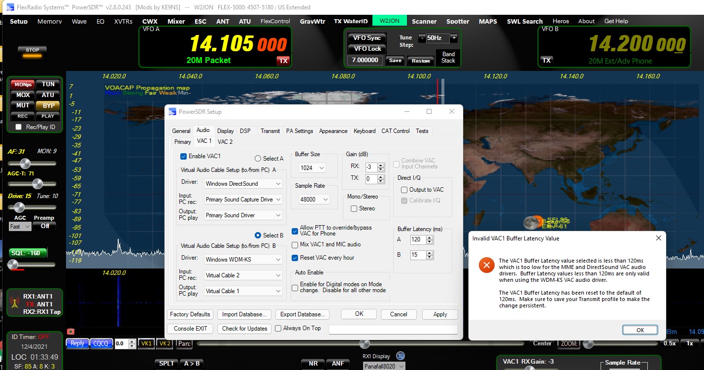

When utilizing Windows WDM-KS driver and adjusting the Buffer Latency (ms) any value below 50,
The entered value triggers an "Invalid VAC1 Buffer Latency Value" warning window and resets the latency value to default 120ms.
(in this example I clicked the down arrow in an attempt to change it to 49)
My VAC stream buffer watermark control is not enabled.
I suspect this is just an oversight in the code to check that KS is the current driver.
Perhaps the courtesy value reset function is just trying to be overly helpful even though it isn't required in this situation.

I can see that near line 5059 clearly it is supposed to allow the change if Windows WDM-KS is the driver selected.
Code: Select all
            if (((new_driver_name != "Windows WDM-KS") && (new_driver_name != "ASIO")) && udAudioLatency2.Value < 50)
                MessageBox.Show(new Form { TopMost = true }, "The VAC1 Driver type selected does not support a Buffer Latency value less than 120ms.  " +
                    "Buffer Latency values less than 120ms are only valid when using the WDM-KS VAC audio driver.\n\n" +
                    "The VAC1 Buffer Latency has been reset to the default of 120ms.  " +
                    "Make sure to save your Transmit profile to make the change persistent.",
                    "Invalid VAC1 Buffer Latency Value",
                    MessageBoxButtons.OK,
                    MessageBoxIcon.Error);
                udAudioLatency2.Value = 120;
Fun trick, Both Select A and Select B need to be compliant for it to take the < 50ms value.
I tested by changing both Select A & B to "Windows WDM-KS" and it didn't bark.

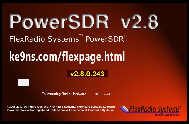

Download .243
You now have a separate Buffer values for A and B VAC1
So you should be able to go down to 15msec with WDM-KS (which was the original limit)

Okay, so it's sort of wonky now.
Out of the gate, Select A will now accept the 15ms setting!
However, it does this regardless of which driver is selected. This is probably troublesome for anything other than the WDM-KS driver.
Select B still refuses to accept anything below 50ms even if the WDM-KS driver is chosen.
The only way to get Buffer B lower than 50ms is to put the WDM-KS driver in Select A, then it allows <50 in both buffers.
Small bug.
