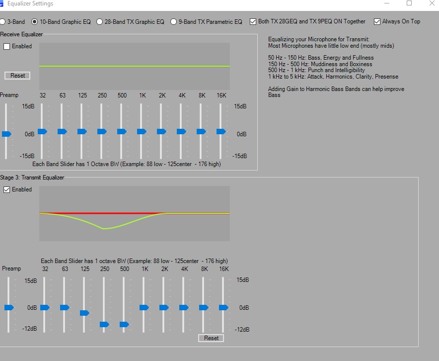

Here is a screen shot the EQ theres not much to them .. if there is anything else i need to give you just let me know .. i appreciate your help .. i have ran out of things i know how to do

Re: Windows 10 pro v1809
I noticed you have the "Both" checkbox ON, but you have the 10-band selected.
I may need to update the code because that should not be allowed.
You would need to have the 28-band or 9-band selected if you want to check the "Both" box.
But I will test it.
Darrin ke9ns.com
go and install .173
That will automatically clear the "BOTH" checkbox if you click onto the 3band or 10band eq.

i think that was my problem .. I have my setting on th EQ and the rest of them in the set up menue set back like they have been and its booting back up without crashing... i also have it set on the 192000 sample rate and its running great.. i have never been able to run it on that not from day one it would lock up and crash every time i tried it .. i don't know what changed .. i am just glad it did thanks a lot for your help
