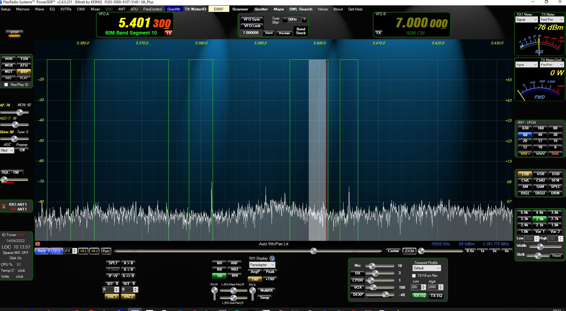

Screenshot of my 60m receive. I've also taken a video of a UK station in QSO on both the Hack Green web SDR where the station is on 5371.5Khz USB and on PowerSDR where I had to tune to, 5401.3 LSB to receive the station. I can send that file to you if you like..?

A few things I noticed.
It looks like you have your setup->audio->primary->SR = 96khz instead of 192khz
You should not have VAC2 enabled (1 or 2 but not both). And you dont need VAC1 enabled unless you need the audio sent to your PC.
TNF should only be on if you need to create a TNF (using the +TNF button)
Do you want UK_plus or some other Turf Region?
CTRL+SHIFT+D ->Low level hardware control->TURF
this will allow you to change the TURF
Then go into the database folder: %userprofile%\AppData\Roaming\FlexRadio Systems\PowerSDR v2.8.0\
and move all 5 files (with your radios serial number in the file name) out of this folder.
This will force a EEPROM calibration read and a new database.
also try a setup->General->Calibration->5.0000 (assuming you can hear WWV on 5mhz)
does it calibrate?
If it still is acting strange, you might try changing the TURF to US, cycle power and hit the UpdateBandText button after you power up PowerSDR and see if anything clears up?
I am not sure how the software can even do what your describing?
