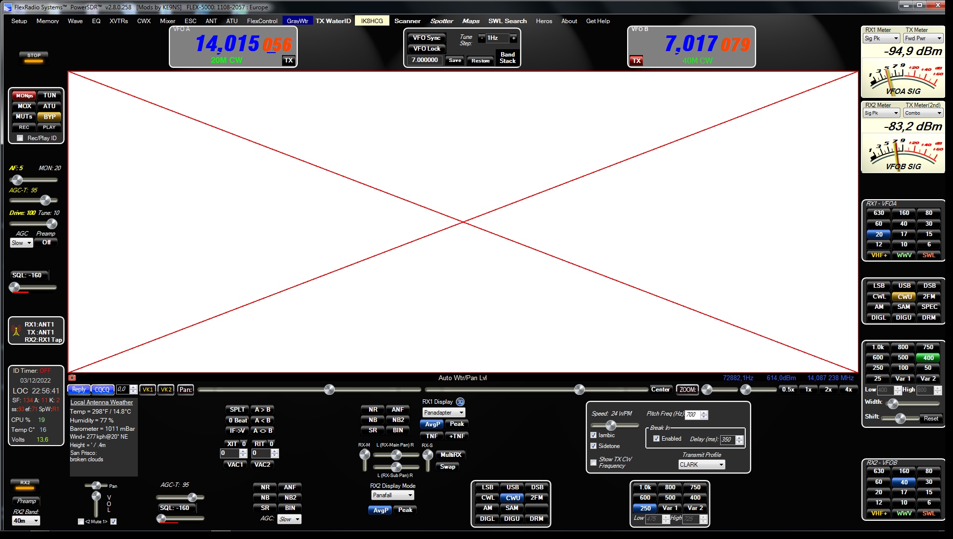

does it happen very rarely, video card or fire wire problem?
- SDRScreenSave__CWU_14,015056MHz_03-12-2022 22_56_41.jpg (561.4 KiB) Viewed 98571 times

The screen is probably not related to FireWire.
Every time I have seen a Pan crash it was due to some setting (in SETUP) was found to be invalid.
Usually a fault message screen will pop up (it might be hidden behind the console screen).
It could mean that your database has something corrupted in it.
But I would need to know the fault message.

Hi Darrin
I didn't notice if any error message came out with the description. As soon as it happens again, I'll do more attention and attach what the message says. I don't even remember what I did to make this interrupt happen. I can only tell you that everything else works, change band, tx, rx, change filters etc etc

Re: Flex 5000 very rarely Topic is solved
It was an overflow due to the hi-res panafall huge display buffer size, and displaying the CW signal on the panadapter when your zoomed out.
Its fixed now.
