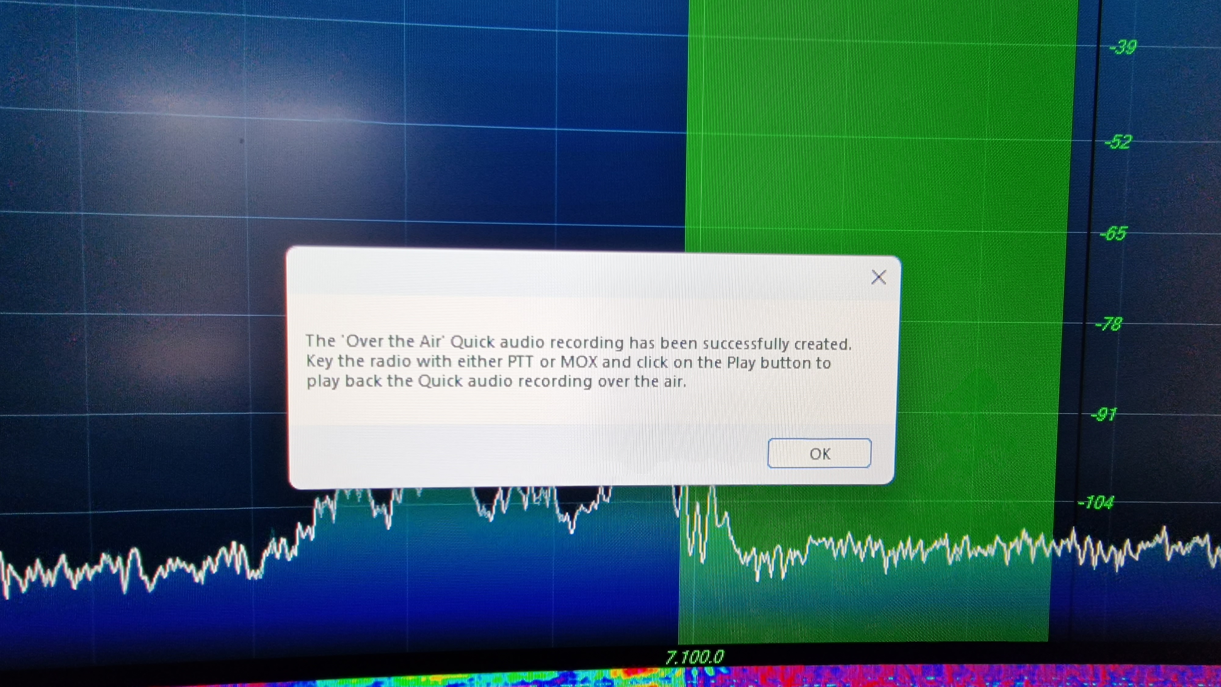

I have a problem with recording, once I play an audio track by pressing REC , if I go to play it by touching PLAY it doesn't allow me to do anything and I see this screen late....
There is something else to adjust about the audio track, they tell me it doesn't play well
Audio track problem
Audio track problem

When you hit the REC button, it starts Recording audio from RX1
You MUST hit the REC button a SECOND time to End the recording.
Now put the Flex in Transmit mode, and hit the PLAY button.
The PLAY button is just to play the audio back over the air while Transmitting.
If you want to hear the recordings your making, click on "Wave" (top line of PowerSDR console window) and click "MP3 Folder"
All the recording you make go into this folder as MP3 files with the time,date,freq,mode.
