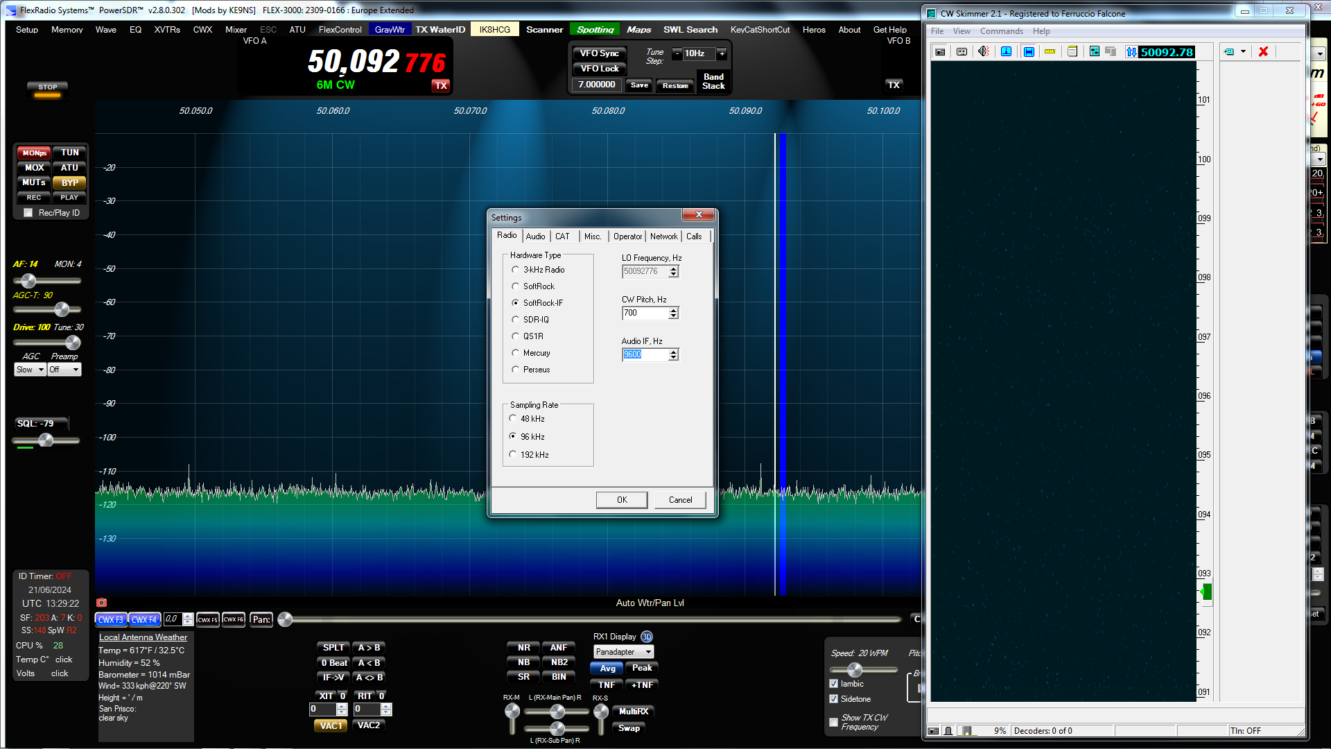

I have this strange problem with cw skimmer.
CW skimmer works regularly in all frequencies, but in the 6 meter bands I don't get the decoding of CW signals. the program reads the freq. on the left window it reads the signals in morse code, the percentage is working but no call on the right side so I can't select any signal because it doesn't read the call, the word decoders is 0

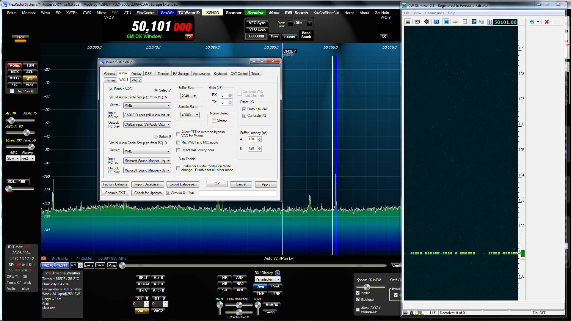

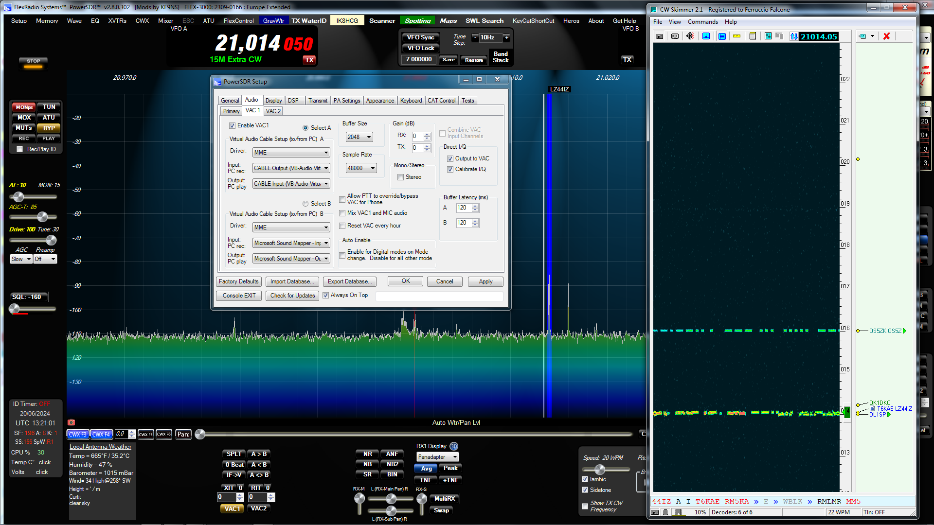

Take a screen shot of the VAC1 settings on HF and a screen shot of VAC1 on 6m
Also, Make sure you do not set the Buffer latency too low. If its too low and your PC is unable to keep up, it can cause issues with the audio output.

keep in mind that i m running now with flex3000
i'll do.
Setup-General-Options Process Priority= Abobe Normal
Setup-Audio-Primary Buffer size 1024, Sample rate 96000
VAC1 select (A) Buffer Latency A=120, B=120
VAC2 not enable 120
VAC1 Buffer size 2048, Sample rate 48000
with these settings it works regularly across the entire HF spectrum, I also see signals at 160m where there is no antenna

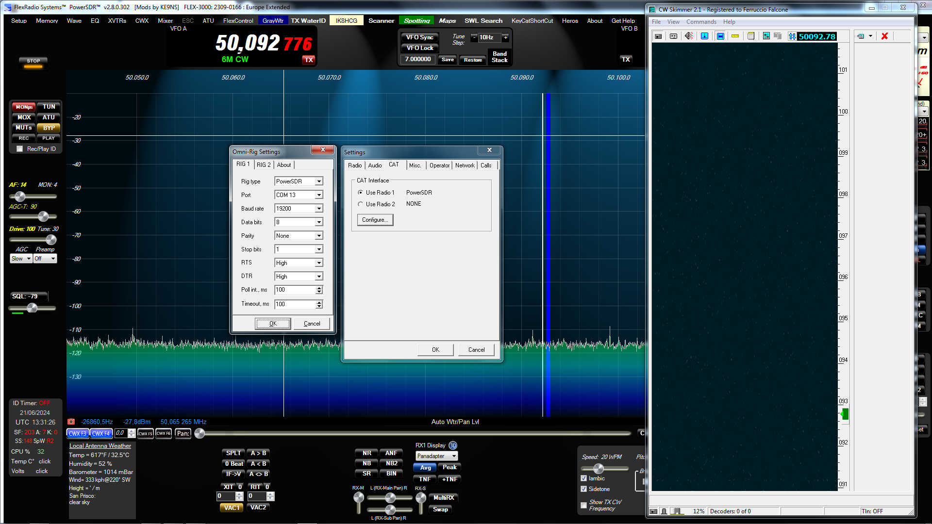

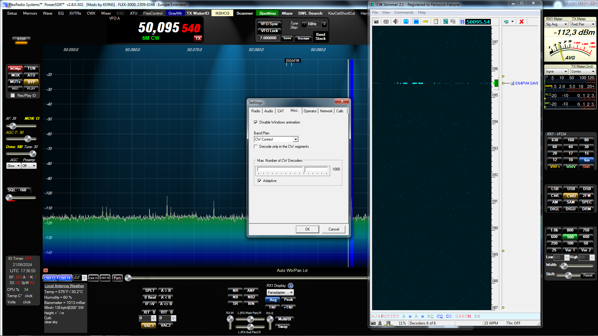

What are your CW Skimmer: Settings->Misc? Mine is set to 1500 decoders and Adaptive is ON
Settings->Radio is set to SoftRock-IF

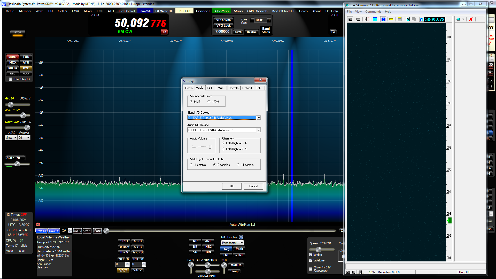

Settings->Audio is WDM (I always use Windows DirectSound instead of MME). Channels Left/Rigth = I/Q

where are these functions 1500 decoder and Adaptive is active in cwskimmer?
Re: cw skimmer does not decode on 6 meters
Settings->Misc

was setted 1000, adpiteve flagged

Darrin solved everything apparently without understanding.
I have flagged Disable windows animation. but what does this have to do with decoding?
Re: cw skimmer does not decode on 6 meters  Topic is solved
I assume the Max number of CW Decoders is a setting to limit the CPU loading on a busy band (like during a contest),
but I was thinking that maybe you had it set to a very low number or 0
I am glad you got it working, but I am not sure why it was not working before?
Also interesting that you can set CW Skimmer to ignore outside of CW segments, but you need to properly select your "Band Plan" to your location otherwise it will not decode CW. This is probably to also reduce CPU load as it tries to decode all signals on the available bandwidth.
