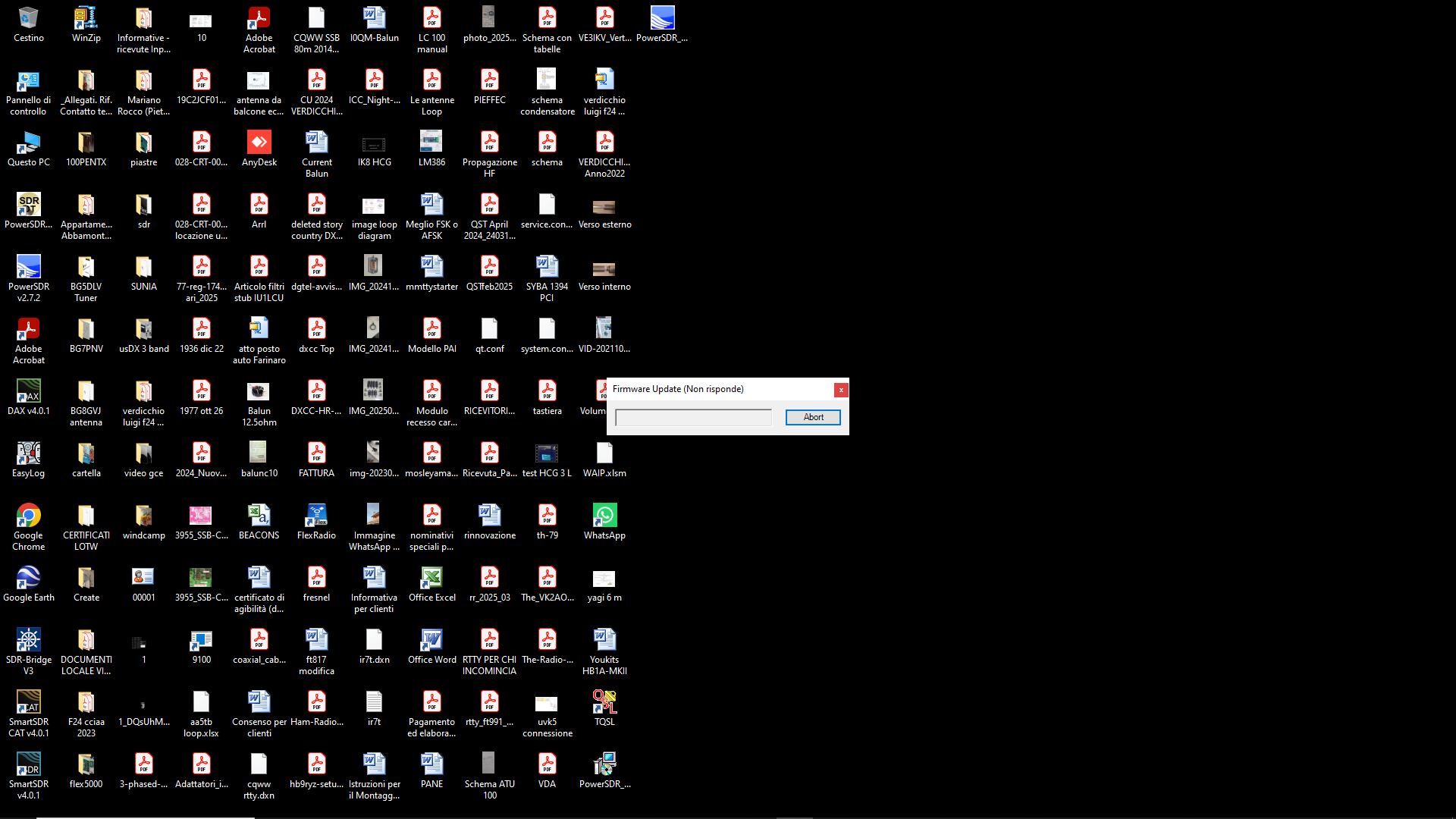

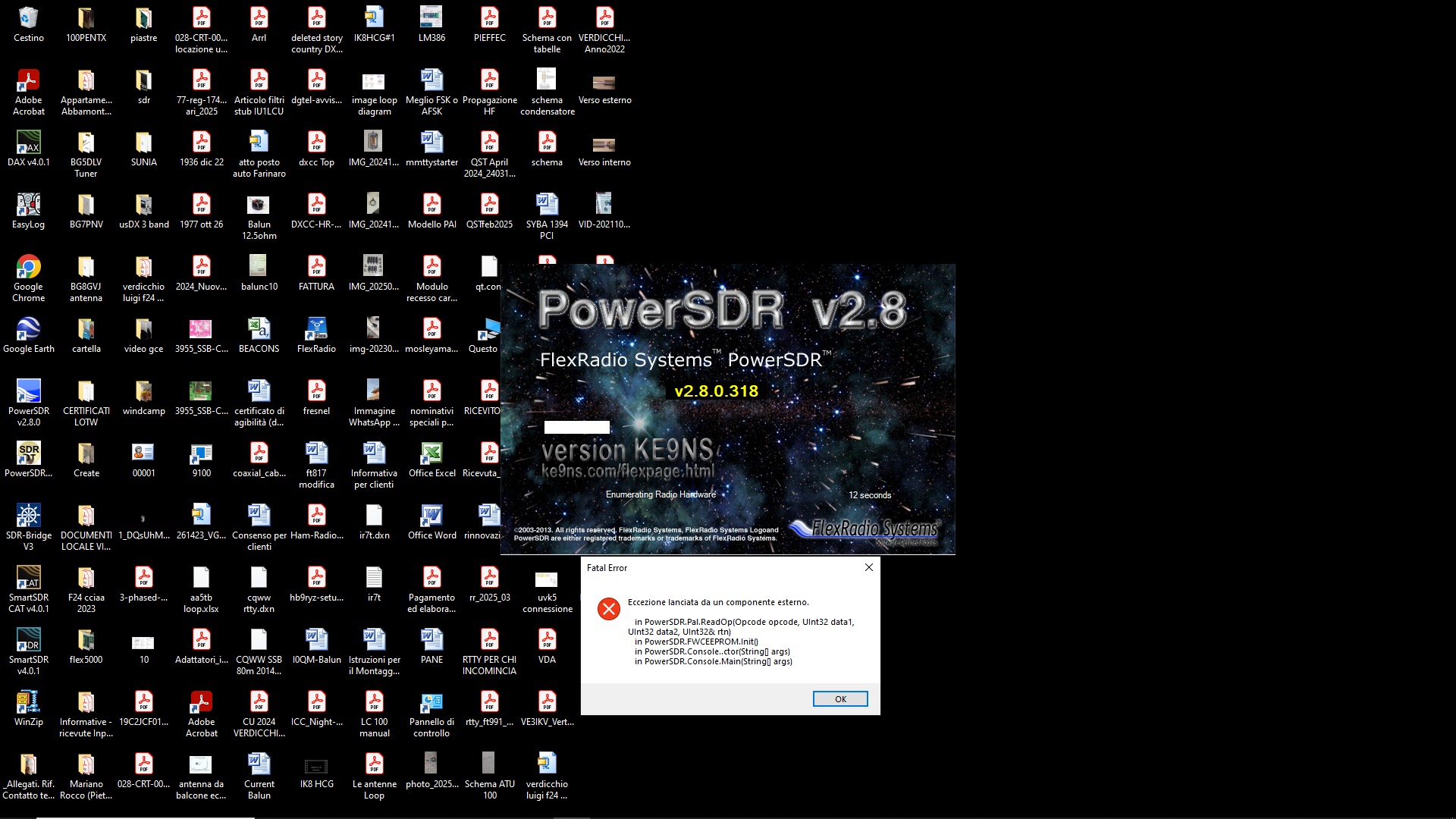

Never had any problems with Win7, I got a new PC but with Win10 Pro platform. I loaded software, loaded legacy files for FireWire but nothing to do to get Power SDR to start.
on the same PC I also have ssdr with Flex 6400 but I don't think it has anything to do with it. On the old PC with Win7 they both worked.
problem to start up flex3000 Win10Pro

I changed the FireWire and it didn't change anything. Both are PCIE chipsets with NILOX VIA ports, the other is StarTech also VIA. When I changed the FireWire port inside the PC, I launched Powersdr and it asked me to load the firmware, asking me if I'm using a Flex5000. Yes or not. I wrote "No." Then it asked if I'm using a Flex3000. I answered "Yes." But the loading bar remains white, even though it tells me the firmware has been loaded.

I followed your instructions and reloaded the power sdr. Nothing.
I'll try looking for a Texas Instruments FireWire card with the chip you mentioned. But to rule out anything else, I'll look for a Windows 7 PC and see if it works with these two available FireWire cards.
I also deleted v.2.8 and installed 2.7
Can you suggest me how to clean powersdr from this PC without leaving any traces of files?
