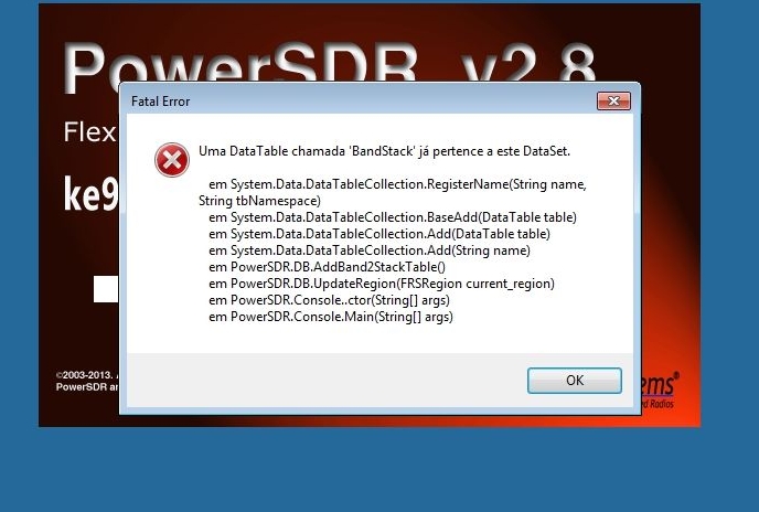

Hi:
I think this is the screen you're seeing:
This error only occurs on new installations and the first time you run PowerSDR.
Close this window by clicking the OK button and run PowerSDR again.
- FATAL-ERROR-2.jpg (128.19 KiB) Viewed 19240 times

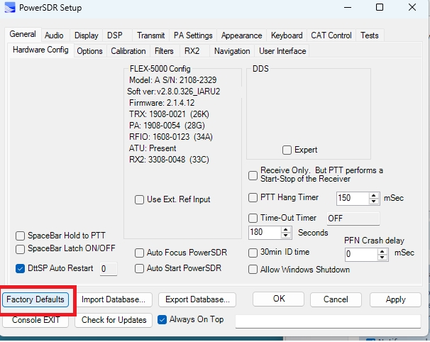

Re: Fatal Error trying to load PowerSDR 2.8.0.326
TRY delete PowerSDR database clicking in Factory Defaults button
- Default.jpg (127.83 KiB) Viewed 19213 times
Well I got to the same solution, but took a different route!
First I reinstall in PowerSDR software which took me back to 2.8.0.118. I tried to reload my exported database from a few days ago, but it would not load. I then rolled back to Factory Defaults. Then I install the latest update (2.8.0.326).
Everything seems to be working except I lost all me settings. My virtual audio cables and comm ports were still there, but PowerSDR didn't know about them. I currently working my way through all the settings and different modes to get everything working again.
Thanks for all your suggestions and help!
