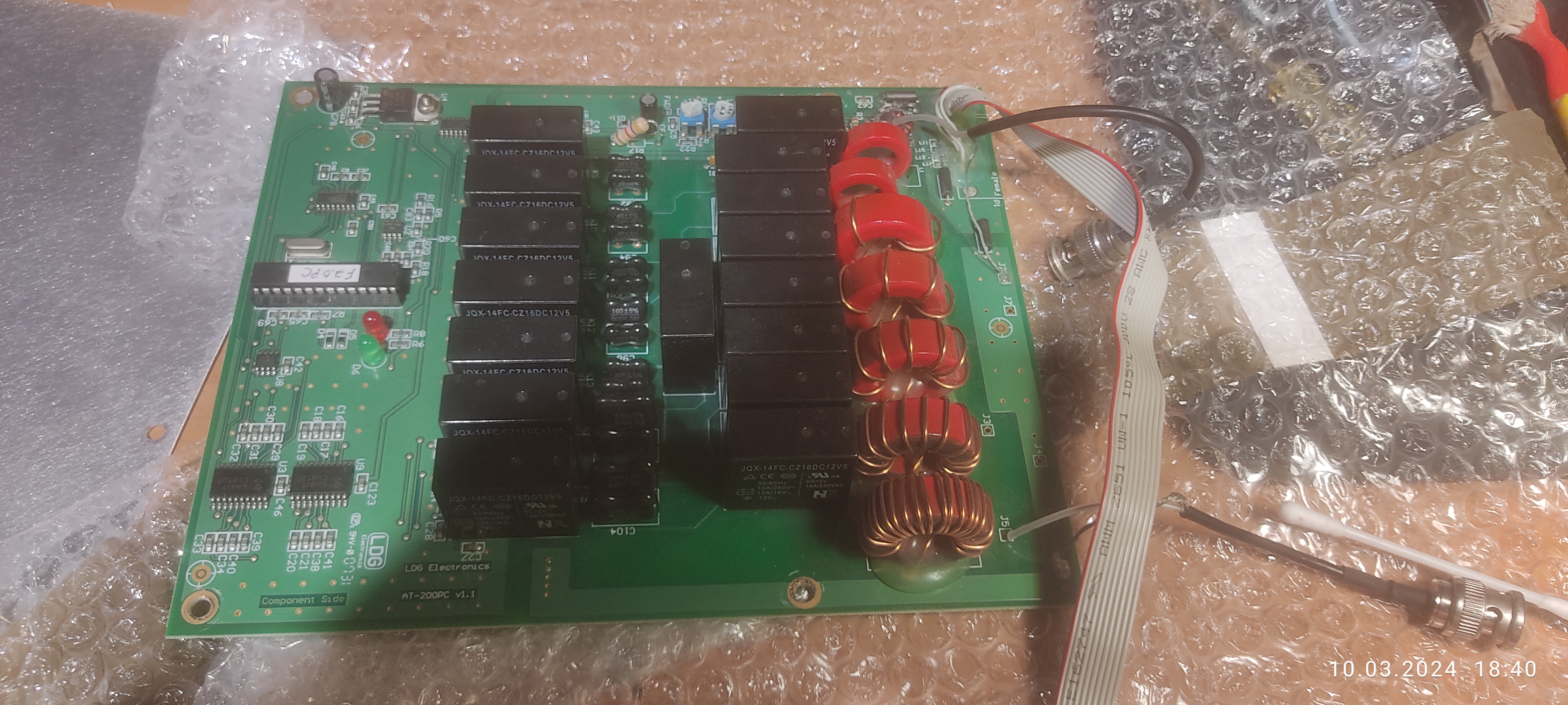

Posts: 67
Joined: Thu Aug 05, 2021 4:58 pm
Re: Internal ATU
Post by IK8HCG »
this was my Tuner in my old Flex 5000 which has always worked without any problems from day one
lou

Posts: 575
Re: Internal ATU
Glad you got it working!!
I was hoping that the Debug screen "EEPROM firmware update" was going to automatically populate the serial# and rev#, but obviously not. My next step was to tell you about the EEPROM.exe, so I am glad you found it (for future reference: The EEPROM download is also located on my website under the technical info section).
I didnt realize the LDG version works as a rev 52A, so that is good to know.
My original Flex-5000 has the LDG ATU, and my current Flex-5000 with the 2m/70cm option has the FlexRadio rev52B ATU
