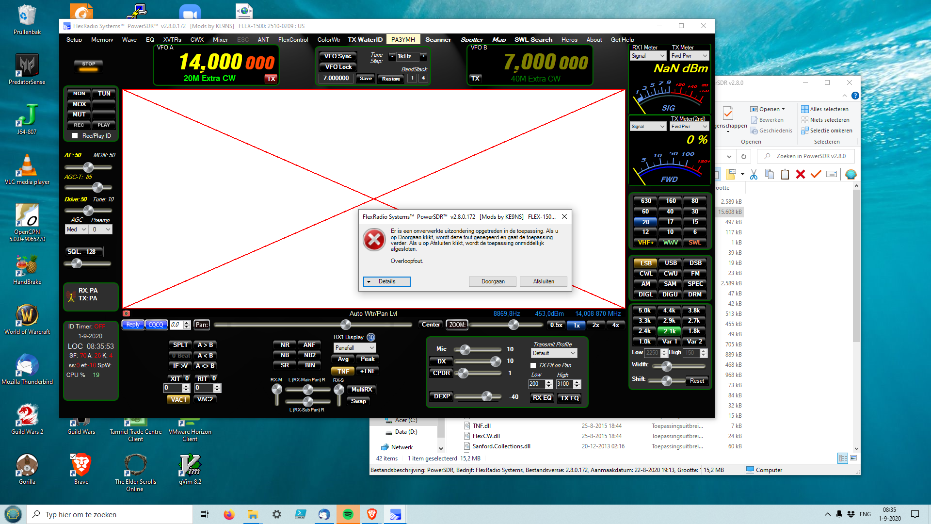

Sorry for the dutch text. If necessary I can see how to change the language. The screenshot should be attached to the message. Below is the traceback.
Zie het einde van dit bericht voor meer informatie over het aanroepen
van JIT-foutopsporing (Just In Time) in plaats van dit dialoogvenster.
************** Tekst van uitzondering **************
System.OverflowException: Overloopfout.
bij System.Drawing.Graphics.CheckErrorStatus(Int32 status)
bij System.Drawing.Graphics.FillPolygon(Brush brush, Point[] points, FillMode fillMode)
bij System.Drawing.Graphics.FillPolygon(Brush brush, Point[] points)
bij PowerSDR.Display.DrawPanadapter(Graphics g, Int32 W, Int32 H, Int32 rx, Boolean bottom)
bij PowerSDR.Display.RenderGDIPlus(PaintEventArgs& e)
bij PowerSDR.Console.picDisplay_Paint(Object sender, PaintEventArgs e)
bij System.Windows.Forms.Control.OnPaint(PaintEventArgs e)
bij System.Windows.Forms.PictureBox.OnPaint(PaintEventArgs pe)
bij System.Windows.Forms.Control.PaintWithErrorHandling(PaintEventArgs e, Int16 layer)
bij System.Windows.Forms.Control.WmPaint(Message& m)
bij System.Windows.Forms.Control.WndProc(Message& m)
bij System.Windows.Forms.Control.ControlNativeWindow.OnMessage(Message& m)
bij System.Windows.Forms.Control.ControlNativeWindow.WndProc(Message& m)
bij System.Windows.Forms.NativeWindow.Callback(IntPtr hWnd, Int32 msg, IntPtr wparam, IntPtr lparam)

- Powersdr_screenshot.png (721.82 KiB) Viewed 91750 times

So it seems that some settings that the radio returns to PowerSDR is causing the problem.
Re: Flex-1500 problem when switching band
Yes I am starting to think the calibration stored in the EEPROM of the Flex-1500 is bad, and it is causing the issues your seeing.
I took a copy of my Flex-1500 database (which includes the calibration data for my Flex-1500).
I Changed the serial number over to your radio 2510-0209.
BUT FIRST you will need to change the TURF back to "US" before doing anything else.
Go into your database folder: %userprofile%\AppData\Roaming\FlexRadio Systems\PowerSDR v2.8.0\
Delete any file with your radios serial number in the file name (there may be up to 5 files)
Now unzip this 2510-0209.zip file, and drop the "database_RevQ_F1.5K_2510-0209.xml" file into your database folder.
Run PowerSDR and see if your Flex-1500 works?
If it does work, there is a way to update your radios EEPROM to make the update permanent and then you can change the TURF back to 20
Darrin ke9ns
Darrin ke9ns
- 2510-0209.zip
- (20.43 KiB) Downloaded 3656 times
I have tried it, but the result stays the same. The first attempt even crashed on 40m, but after 1 or 2 tries I could not reproduce that.
I did a diff of your xml with a generated xml to see if that could give me a clue. I saw a comma as a decimal separator. So I changed my locale, but that also didn't work.
I also noticed a "checksum_error.log". That file contains
Henrico
I hope this gives you a clue on what I could try next. Thanks for all your help.2-9-2020 08:23 RX Image Gain Checksum Error DB: E1 EEPROM: FF Calculated: E1
RX1 Image Phase Checksum Error DB: F1 EEPROM: FF Calculated: F1
TX Image Gain Checksum Error DB: D8 EEPROM: FF Calculated: D8
TX Image Phase Checksum Error DB: AA EEPROM: FF Calculated: AA
PA Power Checksum Error DB: 24 EEPROM: B6 Calculated: 24
Henrico
I forgot about "locale" issue between you and me (decimal point vs comma).
Using my database would definitely cause a crash.
I am not sure what "locale" you have setup on your PC, but the only thing I can think of doing (as a test) would be to find another PC where the "locale" is not the "locale" you are currently using (maybe try U.S. or U.K.), then do a fresh install of PowerSDR on that PC, and see if it crashes?
This is just to make sure the specific "locale" your using is not the cause of what you are experiencing?
Also let know the "locale" your currently using on your PC (I assume Netherlands?). I have my Flex-1500 on a Win10 laptop and may try changing the "locale" to yours as a test.
Darrin ke9ns
Darrin ke9ns
Changing my locale to make a point the decimal separator did not work. But I wouldn't understand way the wrong locale would only manifest itself when using ham frequencies of 30m and above. For example receiving on 13.990MHz works without a problem. But tuning to 14.000MHz causes a crash.
I will try to do a reinstall with another locale tomorrow. Another bit of information: on my old netbook containing PowerSDR 2.0.2 I saw the same eeprom errors. But I cannot recall if that version could use 30m, 20m, etc. Since the last time I used PowerSDR on that pc I upgraded to W10, and the old version doesn't work anymore. Version 2.8 gave the same error as on my current laptop.
Henrico
Henrico
When you go inside of a ham band the filtering changes (You usually hear a relay click on the inside of the radio) and Calibrations for the new band are loaded up for RX and TX.
So when you go from 13.990 mhz to 14.000 mhz, the band changes causing calibrations to change, but something isnt correct, and you get an "Overflow" error (it appears it is referring to the Panadapter FILL (where it fills color under the panadapter signal line).
From Factory defaults the Pan fill is turned ON. You could try turning it OFF and see what happens? (Setup->Display->Fill Panadapter checkbox)
Since you have tried different computers, and different versions of PowerSDR, I am scratching my head on this one?
Just throwing things against the wall, try a different power supply, different USB cable?
After that, you may try contacting Toby from Troy Radio (toby@troyradio.net). He is the official Flex Radio Legacy service provider.
See if he has ever encountered this from a Flex-1500 before?
Thanks, I will try a different powersupply, usb-cable and a complete reinstall using a different locale. Without the panadapter PowerSDR will not crash. But I will also get no audio. I do hear the relays when changing bands, so that seems to be working correctly.
Maybe the calibration settings in the eeprom got corrupted. Thanks for the address of Toby. I will let you know if I get the radio working correctly.
Henrico
Henrico
What happend since 2. Sept. 2020??
