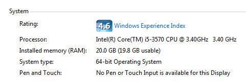

I was running VAC so I removed it and installed VB Cable, seems to be a bit better.
System is shown in attachment. Can't see where to see what the CPU% is.
Max
Max

CPU usage is running around 17%

If your running VB-Cable and you have the Sample Rates matched, and you dont see a massive CPU% spike on the FT8 decodes, you should be good on the Virtual audio side.
Make sure you launch PowerSDR in ADMIN mode. Then you can Click on the "Time Sync" button in the Spotter screen to make sure your PC clock is accurate.
Then after that if you still have issues, you may want to try a different USB port or adjusting the USB settings in PowerSDR?
