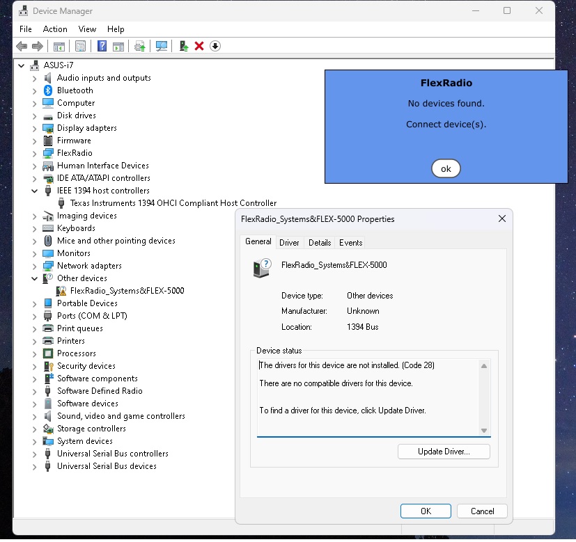

Old Windows 10 PC gone. Had to reinstall from fresh (Win 11 pro) and the 5000K.I hope my problem is simple. It seems related to the FireWire driver?? Maybe it was the steps I took for the initial install?
Anyway, see the attachment as the new PC will not see the radio at all.
TNX!

Same PC but different Win OS? Did something happen, or did you just want to go with fresh Win11?
I have found cases where a FireWire card that ran fine after a Windows Upgrade, failed after performing a fresh/clean install.
And ended up having to buy a new card. What is the TI chip# of your card?
On this new Win11 machine: You ran the Orange Full installer first before the Green incremental installer?
When you ran the Orange Full installer, it did not have any install failures (specifically with the Flexradio drivers for FireWire?)

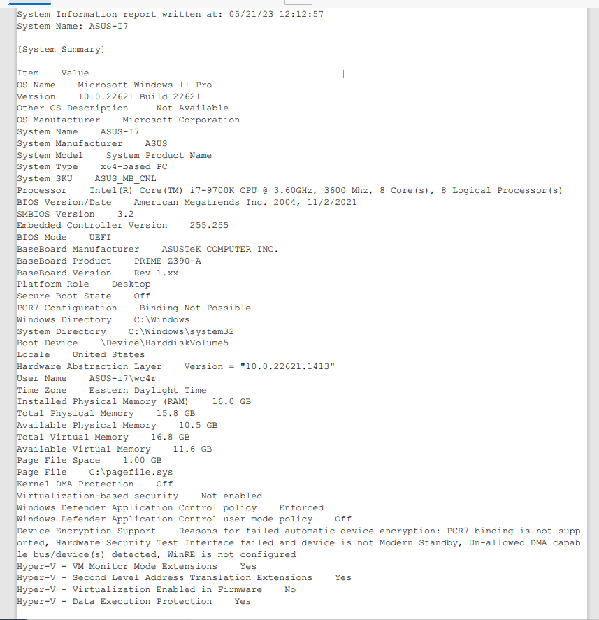

- system info.png (120.72 KiB) Viewed 62926 times
Re: Reinstallation failure
That is definitely a FireWire card or driver issue. I list the TI chip I currently use on my webpage (the FireWire Link on the left side of my webpage) because its still in production. That link also describes using the legacy drivers. If that does not work, I would get a new FireWire card.
