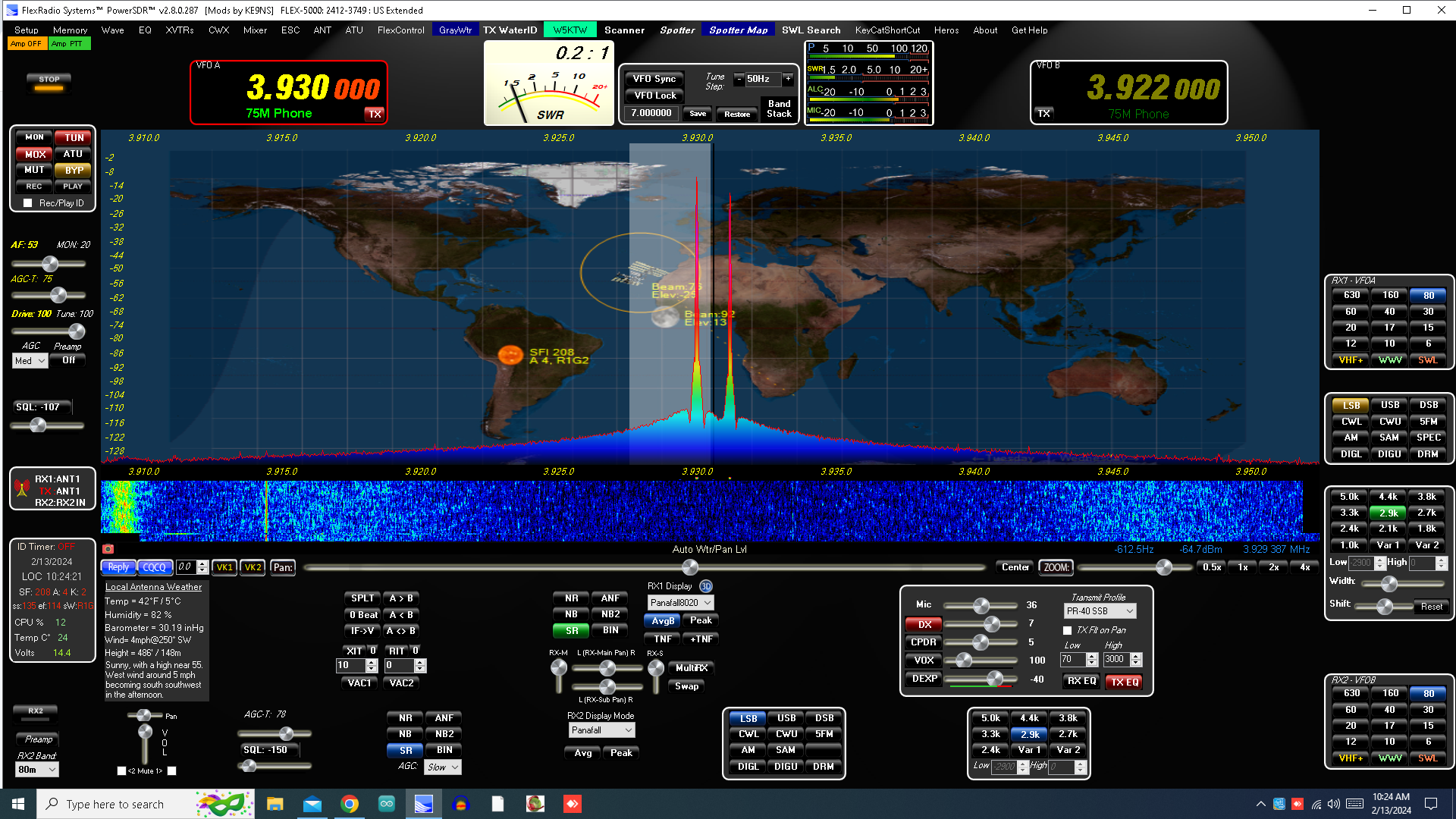

I have two carriers when I press the tune button.

Found the problem. It was the TX sample rate. Set it to 2048 and the scope looks clean now.
