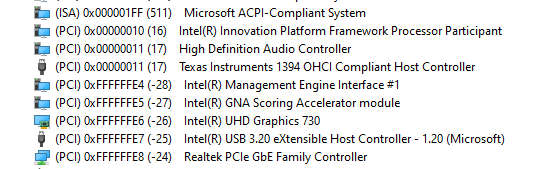

I'm getting BSOD when I hit Off on the Radio software.
latency monitor says:
Conclusion: Your system seems to be having difficulty handling real-time audio and other tasks. You may experience drop outs, clicks or pops due to buffer underruns. One or more DPC routines that belong to a driver running in your system appear to be executing for too long. Also one or more ISR routines that belong to a driver running in your system appear to be executing for too long. One problem may be related to power management, disable CPU throttling settings in Control Panel and BIOS setup. Check for BIOS updates.
I have the latest updates and Bios was just updated on the first setup yesterday.

I just followed your instructions in "I have a FireWire (left side) link on my website showing all the things related to FireWire issues"
I do have a conflict.
Screenshot 2024-05-14 131911.png (19.24 KiB) Viewed 424441 times
I tried disabling the firewire and enabling it with no luck even rebooted then tried enabling it with no luck.
Mitch
N2RGA
Re: BSOD New Computer
Have you tried running just the normal FireWire drivers (not the legacy drivers)?
When I moved to a AMD Ryzen CPU and motherboard, I run only the standard TI Firewire driver.
You can try moving the FireWire card to any other PCIe slot (no matter how large the slot is).
Some PCIe slots are actually shared with other devices on the motherboard (like a SSD NVME m.2 slot)
From your CPU, I figured you have a very modern motherboard, so I am surprised to see an IRQ conflict?
Modern motherboards typically use MSI (the Negative IRQ numbers) over IRQ (positive IRQ numbers)
A last resort would be to use MSI_Util_v3 and possibly move the "High def audio controller" from IRQ to MSI. If the device is listed as MSI compatible it still comes with a risk, so make sure to do a full System backup, just in case your forced to do a full system Restore, as some devices dont work under MSI.

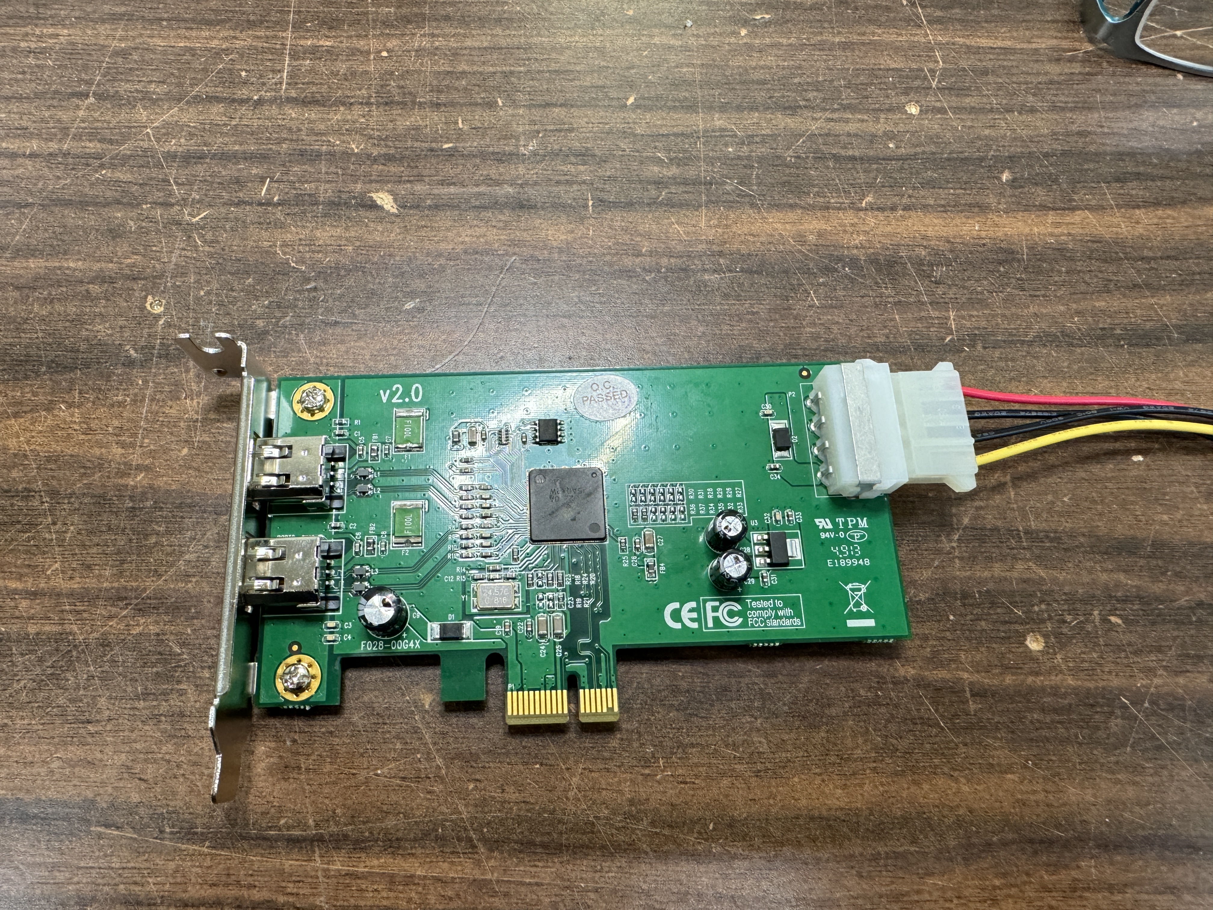

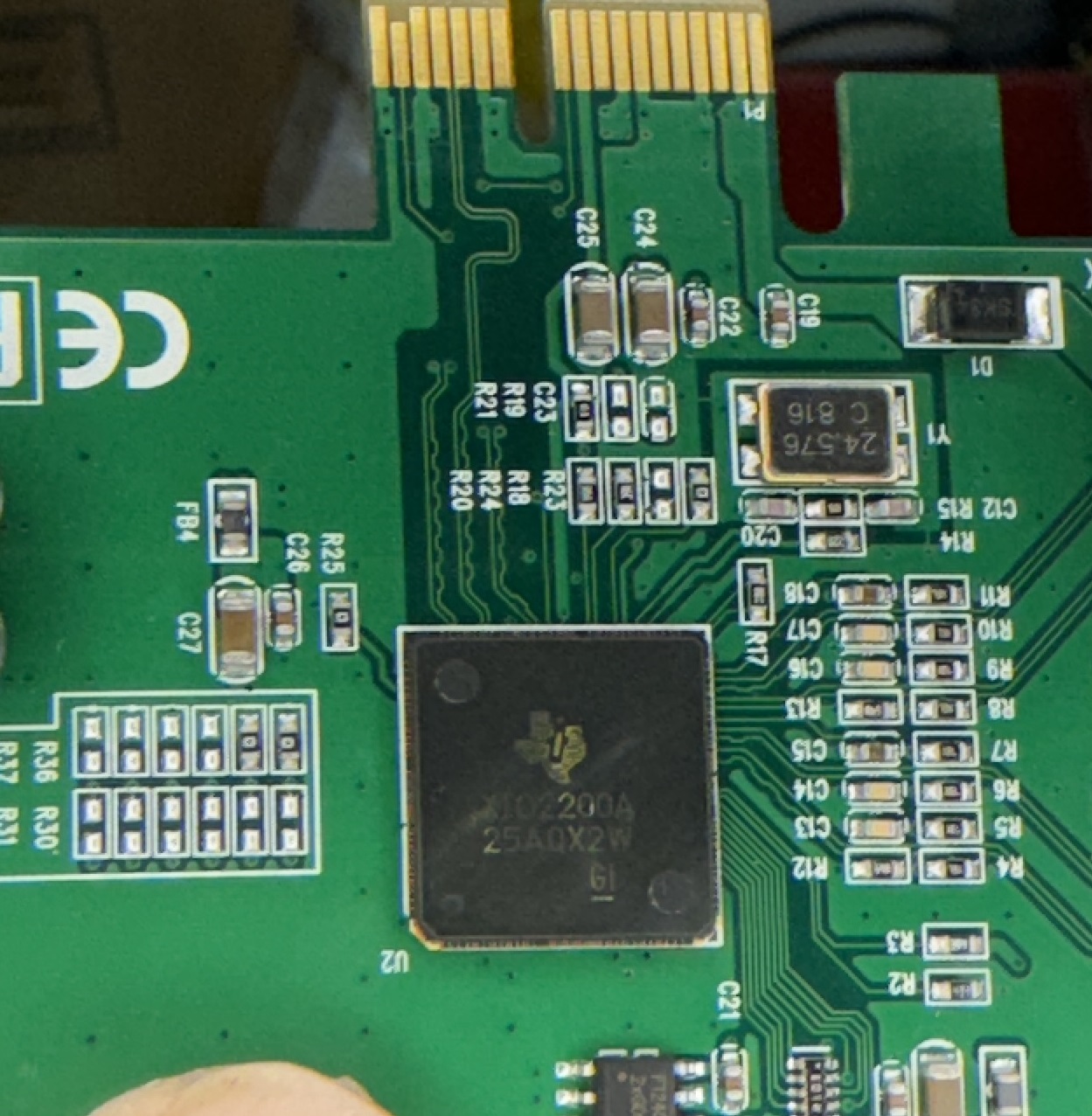

I don't know what card to get now I have the recommended card from the website. and even the one recommended.
Syba SY-PEX30016 3 Port IEEE 1394 Firewire 1394B & 1394A PCIe 1.1 x1 Card TI XIO2213B Chipset?
should I get a TI XIO2213B Chipset or the one Darrin has TI XIO2200A Chipset?
Or one completely different?

Installed New Card same problem BSOD!
Edited:
Still getting BSOD when hitting Stop
