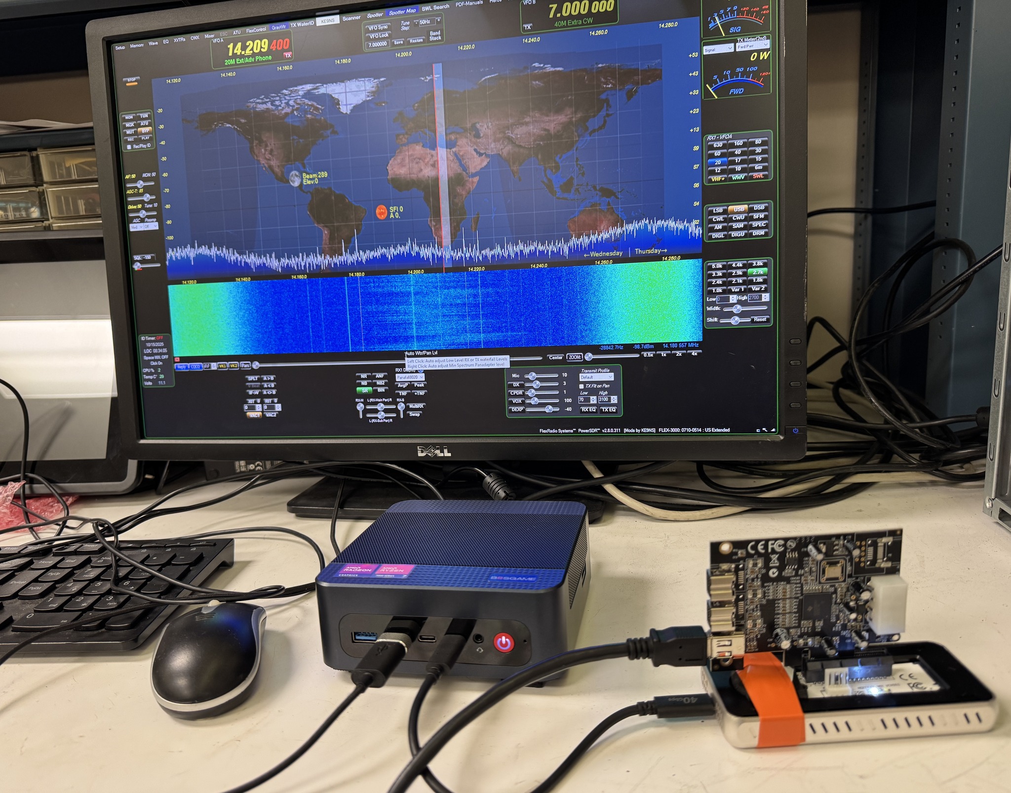

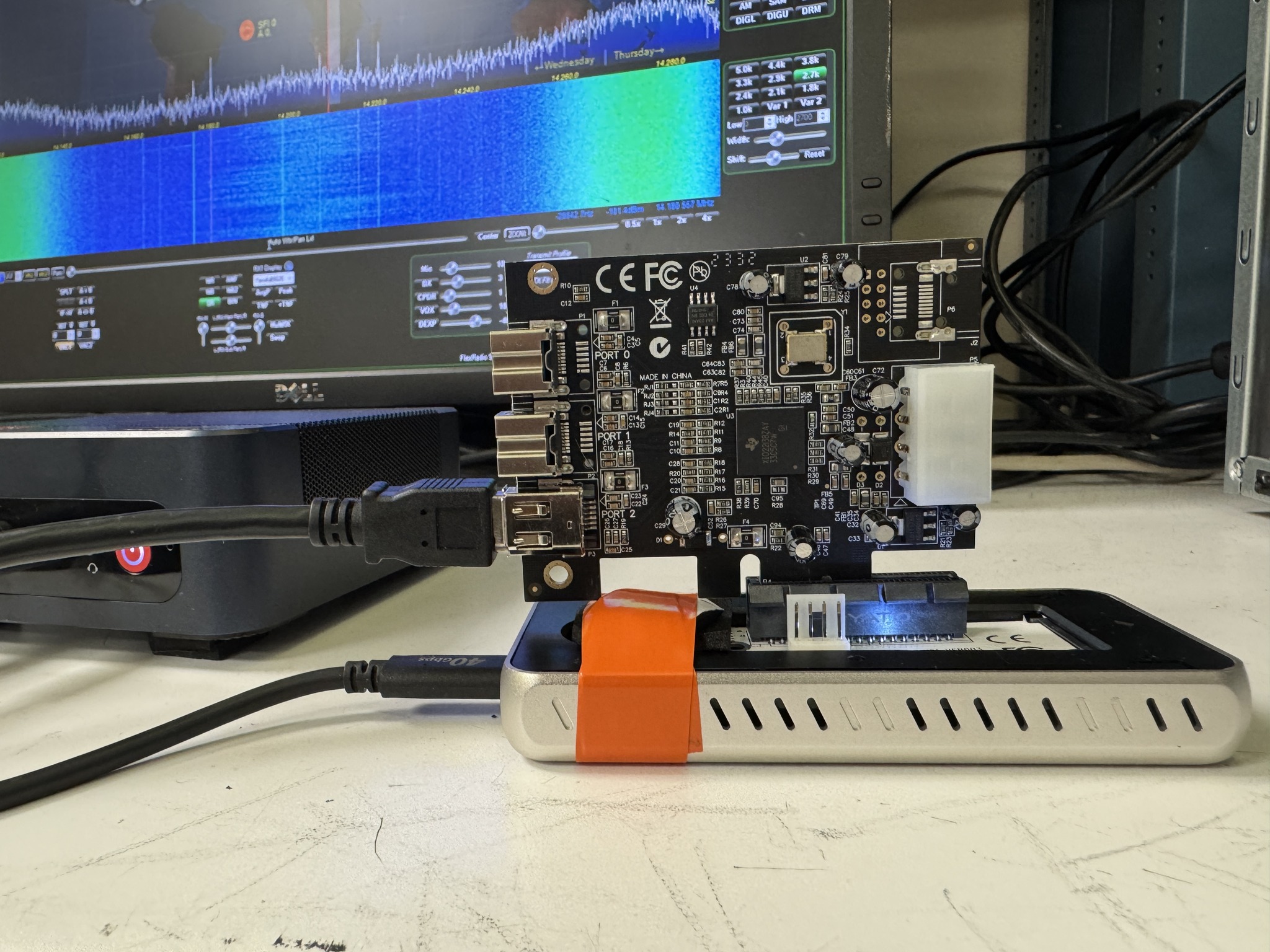

I have successfully run my Flex-3000 and 5000 with PowerSDR v2.8.0 using a mini-PC (BOSGAME M4 Ryzen with a true USB4 port). I used a Wavelink WL-ST401C (USB4 to M.2 adapter enclosure) and a M.2 to PCIe adapter card. The tape is to hold the adapter card because the enclosure does not allow the use of screws). I purchased a SYBA FireWire card that has the TI XIO2213B chip on it (I tried older FireWire cards, both TI and VIA, and found some didnt not work, or only at lower Sample Rates).
