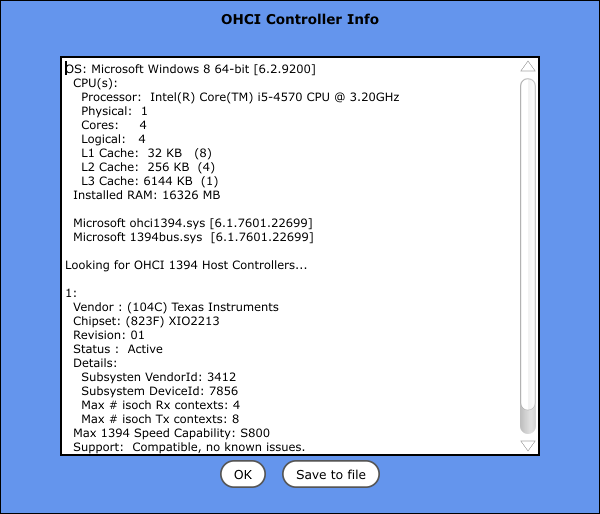

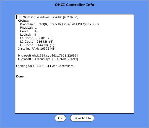

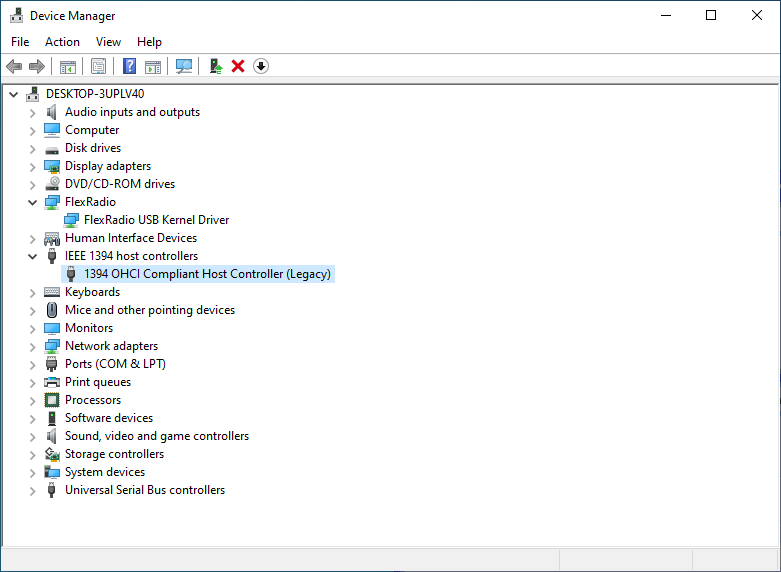

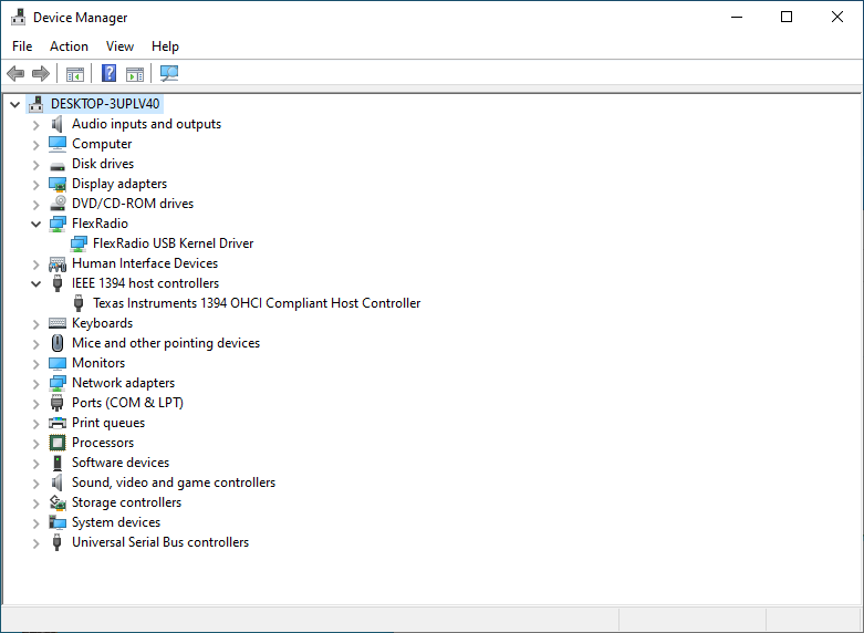

I am having this trouble with my 5000A. I have tried everything I can think of and what is in this chain. I also had originally purchased a VIA chipset card that I replaced with the TI chipset card that you recommend hoping that would help and it did not. I have a Core I5 with 16GB RAM and running Windows 10 Pro. I attached some screenshots showing the results of both the regular 1394 driver for the card and the legacy driver from Windows as you described on the webpage. Any help would be greatly appreciated!
73
Brian - AE7WY
73
Brian - AE7WY

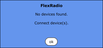

Re: Can´t see my Flex-3000
Here is the 5th screenshot. It would only allow me to attach 4 files at a time. As you can see, when using the legacy driver the Flex software doesn't even see the card but shows fine in Device Manager. With the "factory" driver, the Flex software sees the card with no issue.
- FlexRadio_Screenshot_5_LegacyDriver_20201123.PNG (35.13 KiB) Viewed 210371 times
Its very possible that the "Legacy" drivers have issues with newer Win10 versions.
Every time Microsoft comes up with a major Ver update to Win10, they tend to break drivers.
(if you are switching between drivers, its best to reboot your PC after you make the change, and also pull the 13.8v cord from the Flex-5000)
Your screenshoot_4 looks identical to my info (other than the CPU as I run an AMD Ryzen)
Questions:
So if you run the standard TI driver, FlexRadio app still does not detect your Flex-5000?
OR is it detecting the Flex-5000 but its just not running properly?
When you tried to uninstall everything prior to this, did you also uninstall the "FlexRadio 4.1.3.17357" program as well?
