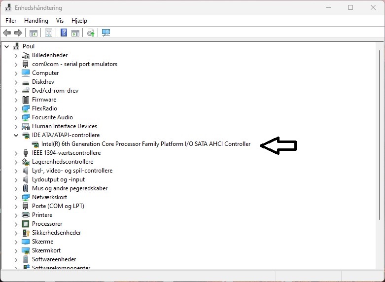

New driver IDE ATA/ATAPI-controllere
Intel(R) 6th Generation Core Processor Family Platform I/O SATA AHCI Controller Must be high setting
no pc breakdown more
Now it works

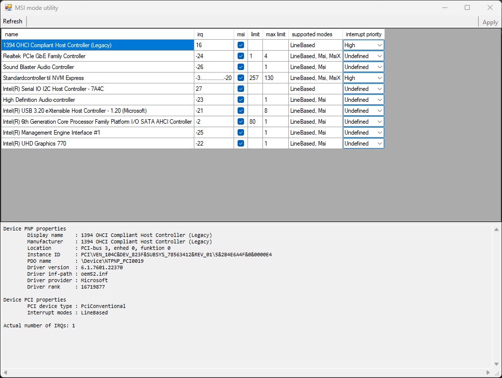

- I download the MSIUtil and disable MSI option for Thunderbolt controller and 1394 OHCI compliant host controller.
- I also define High interrupt Priority for those 2 device in MSIUtil
- I run PowerSDR in Windows 7 compatibility mode and Administrator mode.
I'm actually driving the Flex 3000 & 5000 for many days without any PFN issues. I can activate or disable VAC or change the audio sample rate from 96000 to 192000, "on the fly" without any problem at the moment.
