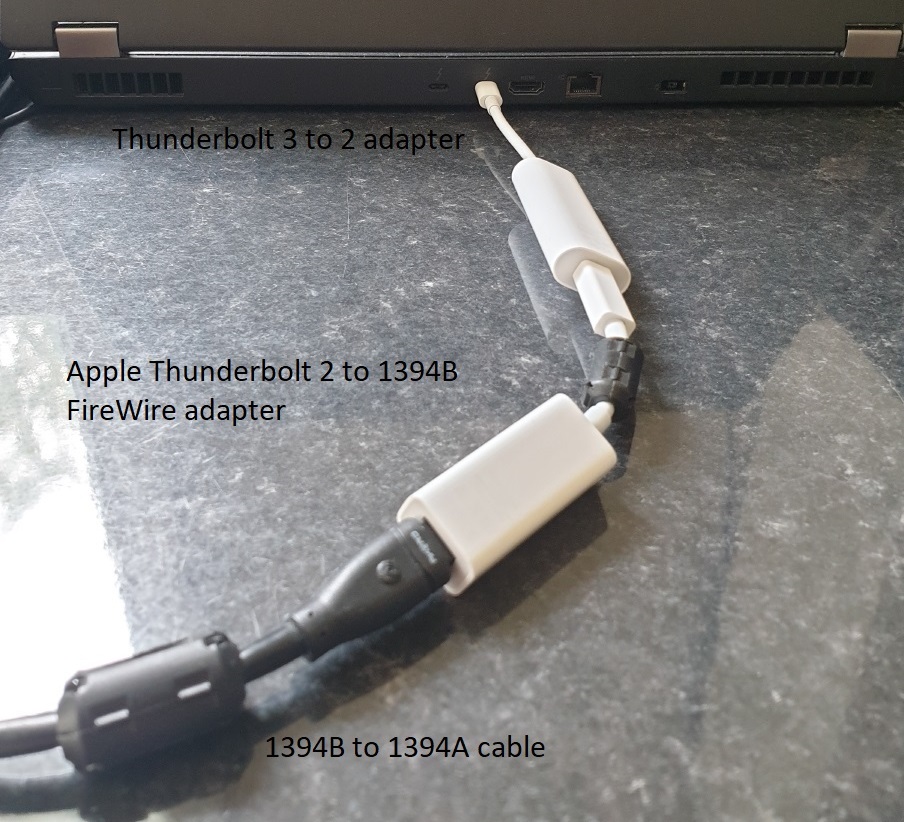

FireWire via Thunderbolt port
Some laptops will come with a Thunderbolt port, OR a USB-C USB4.0 that is Thunderbolt 3 compatible.
Apple (no longer in production) made a Thunderbolt 2 to 1394 FireWire adapter.
You can get a Thunderbolt 3 to Thunderbolt 2 adapter cable.
For USB-C Thunderbolt, you would need to get an adapter to Thunderbolt 3 or 2 to make this work.
See my website for details

Well I I thought that all I had to do was follow the instructions here so I purchased a Thunderbolt 3 to Thunderbolt 2 adapter which is connected to a Thunderbolt 2 to Firewire 800 adapter (rarer than rocking horse doo-doo and very expensive over here!) then Firewire 800 to Firewire 400 cable.
Switched the iMAC on thinking a few software downloads and we're good to go!
However being new to the MAC family I soon found out about partitions, Boot Camp etc etc okay I can follow instructions however after a couple of frustrating hours I found out that my particular model (M3 running Sonoma) doesn't recognize Boot Camp and has been dropped so here goes nothing I'm off to research how to get the software I need to get my Flex5k attached, this should be fun!
