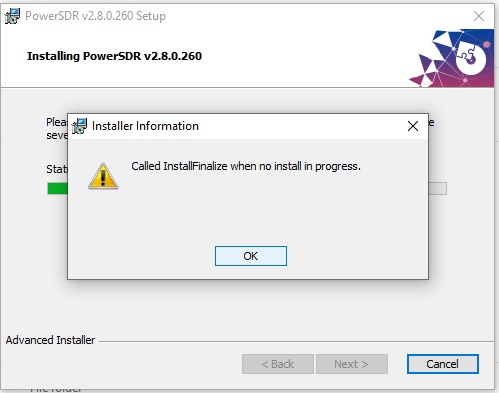

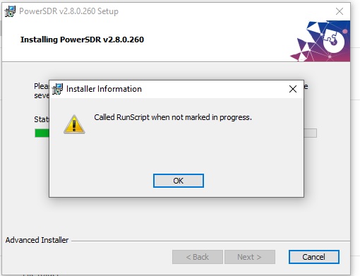

I have 2 Win 10 machines that both will not take the upgrade to the latest version of 2.8.. Please see the attached screen captures of the error messages

Re: Problems with Upgrading to latest Version of 2.8
.263 incremental installs here fine.
Assuming you already have some version of v2.8 installed and running, I would download and try to install .263
I assume your User does have ADMIN level privileges? Meaning your user can install windows updates without asking for a password?
You can try right clicking on the installer and select "Troubleshoot" to see if it can figure anything out.
Those fault messages have to do with your Windows PC user and the folder: C:\Windows\Temp
Your windows user does not have Full ADMIN level privileges to access this Temp folder.
The installer needs full access to this folder.
You can navigate to the folder and right click to allow full access to the folder.
Once you have full access, it should install.
