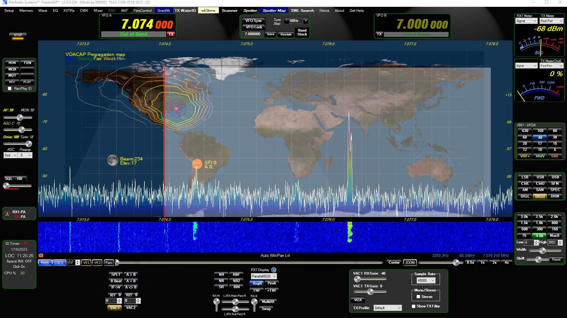

Take a photo of the full PowerSDR console when this happens, so I can see everything.

Here's a pic. I've tried changing bands and scanning around within bands, but 'Out of Band' persists. Otherwise all is working well (as usual).

Re: "Out of Band" below VFO Frequency
Try doing setup->factory defaults.
Then see if it clears up before trying to put back a "backup"

This worked!
