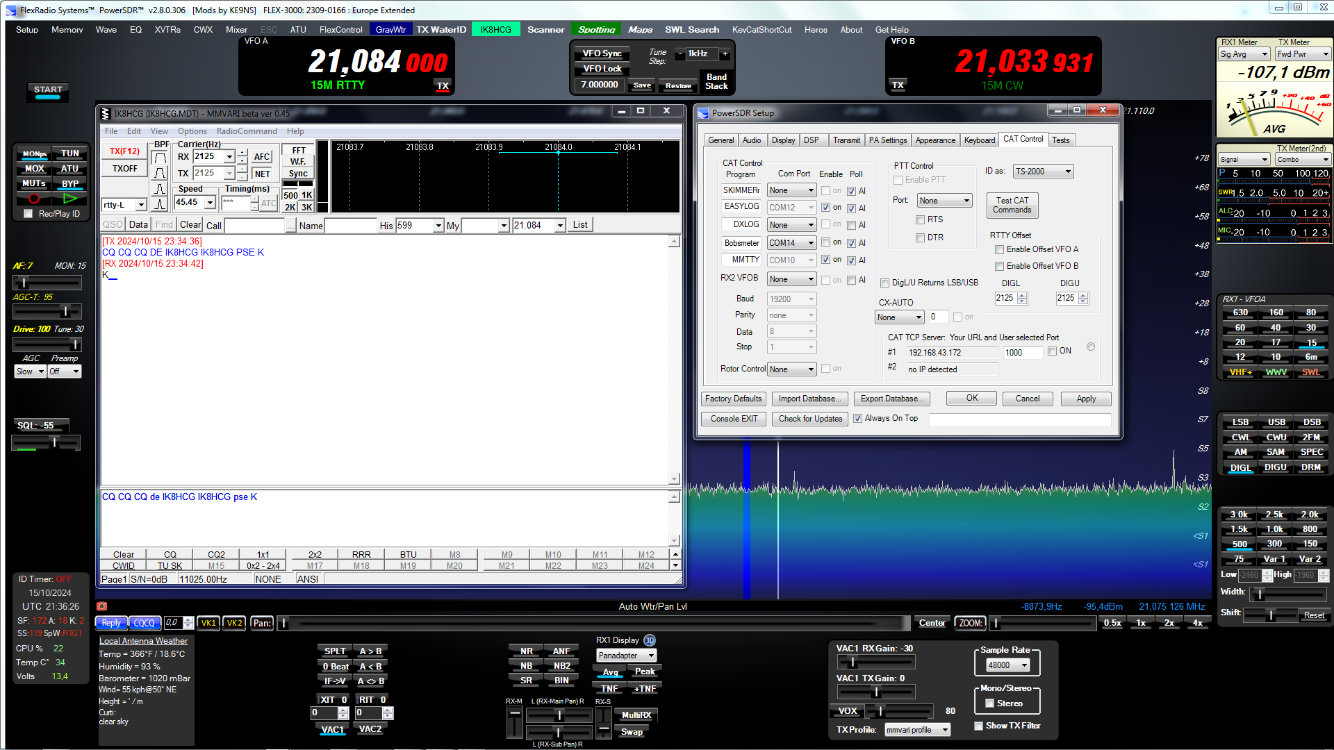

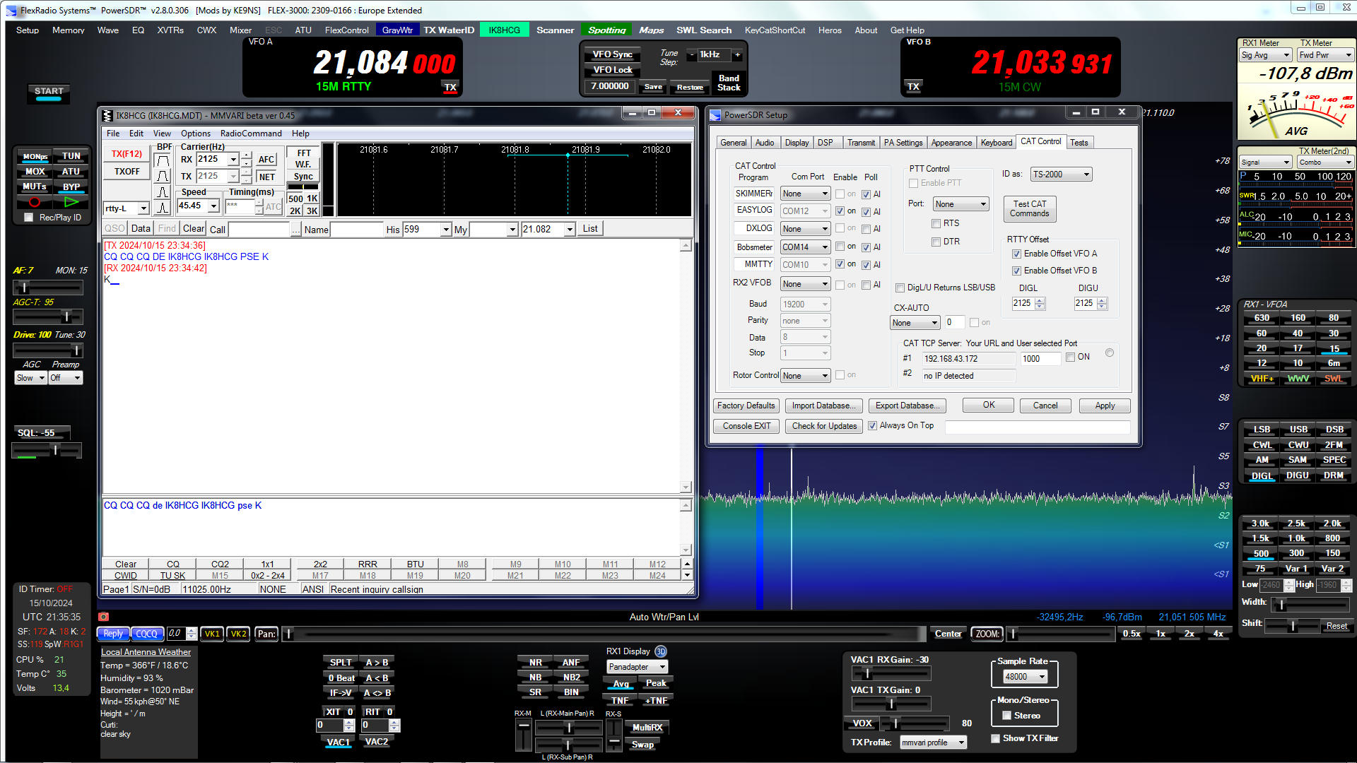

Re: Powersdr (flex3000)+ Dxlog +MMtty
if I enable rtty offset
(enable offset VFO A and B) the MMVARI program reads me 2 khz down, while if I disable it it reads the same frequency as power sdr.
than If I/Q is active in setup-audio-Vac1-Output to vac, mmvari or mmtty does not work normally. clearly if I want to use cwskimmer I have to re-enable it
Correct. It should read 2125hz down from your VFO freq.
Your reported RTTY frequency is supposed to be the frequency of the "Mark" (of the 2 Mark and Space signals). Mark is the signal peak that is closest to the 0hz line. Basically you click on the "mark" signal and your VFO and reported Frequency will always be correct.
Yes you need to manually enable/disable IQ in VAC1/2
I may see if I can tie the IQ ON/OFF setting to the A/B selection of VAC1?

Re: Powersdr (flex3000)+MMtty or MMVari
Let's eliminate the Contest/Log program for a moment.
I followed your instructions to the letter. but unfortunately something is not right for me
1) Click tune/Filter Offsets:
DIGU (Hz) DIGL (Hz) both 2125
Apply.
2) CAT Control:
RTTY Offset: Enable Offsets both A and B
below
DIGL 2125 - DIGU 2125
Apply
position power sdr on frequency 14.100 I demodulate a signal. MMvari reads me 14.096 frequency which is next to 599.
in the Carrier (Hz) RX window I read 2174 depending on how I center the receiving signal. the same in TX 2174.
Enable NET
BPF enabled the first one 3000hz
below Sync ebabled 500
now the strange thing is this that I would like to understand, if I send my CQ CQ DE IK8HCG my friends with whom we are doing tests read me on their displays (frequency) radio 4khz below i.e. at 14.096. if they transmit I don't listen to them at 14100 on my power sdr, I have to look for them by moving the vfo, so we will read different frequencies each on our own radios
if I disable in Cat control Rtty offset both A and B
MMvari reads to me:
power sdr 14.100
MMvari 14.098
if you and I decide to do an rtty test and say let's both go to 14080 with our radios and transmit, I don't demodulate you and you don't demodulate me
hi hi update
to read the same frequency both on powersdr and on the MMvari window I have to set in MMvari :Radio Command: frequency offset: OFF not Auto
it is correct or incorrect to set this way
Apply.
2) CAT Control:
below
Apply
Enable NET
MMvari reads to me:
power sdr 14.100
MMvari 14.098
hi hi update

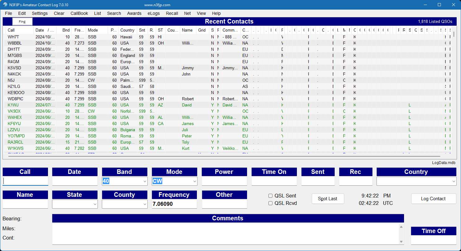

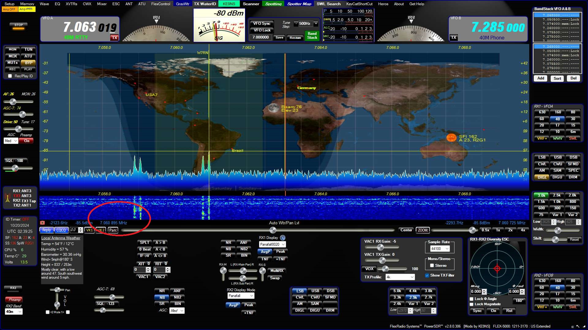

I just tried it an it worked correctly (transmit and receive):
Note: Your RTTY program may have an offset built in. If that is the case its best to 0hz it out and let PowerSDR send the correct offset.
I clicked on the Mark (where you see the "DX Spot" W7RN )
My VFO reads 7.063.020 (which is not important)
Look at the frequency in the red circle I drew on the photo, That is the frequency under my cursor, and that is the value you need to log.
my logging software is reading via CAT, 7.06090 (which is correct)
when I transmit, its exactly where the RX rtty was.
Just make sure your RTTY program and logging software does not have a built in OFFSET, or make sure to 0 it out.
Its working fine
Its working fine

RTTY is FSK modulation.
Your DOC file looks good to me.
So the CAT RTTY offset and Click Tune Offset features are there for those who what to follow that guide.
The 2125hz offset was really just because (back in the day) you needed an external hardware decoder circuit, and 2125hz offset was optimal.
Today, none of that is necessary.
I personally do not use the Click Tune offset or CAT RTTY offset features.
people still use LSB for RTTY on 40m and lower, so DIGL for 40m and lower, and DIGU for anything above 40m
